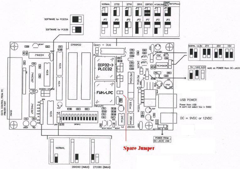

I find this diagram, idk he can help you or no.
It's helpful, but it's not for your programmer.
What is the circled IC?
If this is the flyback diode for the switching regulator, it's not the correct type of diode. It should be a Schottky diode, not a signal diode. That will affect VPP adversely.
But it doesn't correspond to your programmer:
