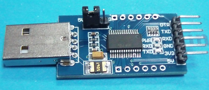

I bricked my router and I need a UART to unbrick it. I'm new to UART's and stuff like that and I don't know what UART to choose. One guy told me mostly I need 3.3V. That UART will be okay https://www.ebay.com/itm/Metal-case-USB2-0-to-TTL-UART-5PIN-Module-Serial-Converter-CP2102-STC-PRGMR/222503843286?epid=1250535213 ?
Also I find in my local shop this USB To TTL Adapter FTDI FT232RL, jumper 3.3v-5v, USB, it will be okay ?
I just read that in case I use a 5V UART on a device where 3.3V need to be used it could blow the chip

This is only one that I found in our local shop USB To Serial 232 Adapter FT232RL (5V-3.3V jumper)
How do you think this will be okay ?

Maybe. So, you want to plug it in to your PC and look (with a meter) at the lines when the switch is 3.3v to make sure that TX really is working at 3.3V. Of course, you want to make sure that the router is 3.3V as well. In other words, you just want to make sure that you are matching the voltages on TX/RX on both sides. Not being paranoid, but they are sometimes misleading (see video below).

Did you look at the voltage on the pins of the USB/Serial chip and your router connections? If so, what were they in each case?
Please explains the details of your connection:
What did you connect to what - which lines went where?
What are the voltages between GND and each of the other pins on the USB/serial chip with the hat switch on 3.3 and also when on 5V?
When you plug the USB/serial board into the PC, can you see which COM port it has occupied? If not, then the driver on the PC is not loading. If so, then make sure you have that COM port selected in Putty.
Sorry for so many questions, but I can't see what is happening on your end.
All like here
https://openwrt.org/toh/ubiquiti/ubiquiti_edgerouter_x_er-x_ka#opening_the_case
I gave it to a friend of mine, and he tested with volt meter. He said is okay.
Yes, I can see. But his name(driver name) is USB Serial Port, but not FT232RL. I tried to change COM port too, nothing changed.
Jumper is set on 3.3V

An easy way to test whether your USB/serial board works is to plug the board into your PC with nothing else connected - just the USB/serial board. Then, connect the TXD line to the RXD line. Open Putty and what you type should also appear in the Putty window. If the USB/serial board works and is recognized by your PC, that will work. Doing this, essentially tells you that the drivers and the USB/Serial board are good and installed correctly and that Putty is configured correctly.
Once you get to that point, you can start investigating further.
edited to add pic

I do not see a way to switch that one to 3.3V.
Using your first pic as an example:
Using a meter - "black cable in COM Input and red in VΩmA and after that use one connect with ground and other to connect " to.... TXD and RXD and DTR and 3.3V and 5V. If it is a 3.3V device, then no pins except for 5V will be above 3.3V. If pins are above 3.3V then you can damage the router if it wants only 3.3V signals.
Remember the video I posted in #6? The "danger" is that TX is at 5V and if it is transmitting to a device on the other end (your router) and that device can not take a voltage above 3.3V, then there can be damage. That is why you check the voltage on all of the pins.
Colors of the leads don't really matter (it's nice for GND-black and 5V or 3.3V-red).
