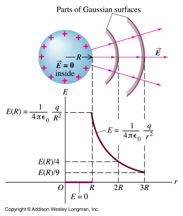

Three flux questions.
1. I have a 36" dia. sphere charged with 10 coulombs. I am standing 10 foot away with a certain number of field lines hitting me due to inverse square law.
Now, without anything changing positions......the sphere is reduced to 1/32" dia. Same 10 coulombs........Does the number of flux lines hitting me change?
2. Change sphere to 36" plate(perpendicular) and repeat. Does number of flux lines change?
3. I invented a variable area capacitor. I put a steady 10 coulomb charge on the input plate.
If I vary the area between the plates........Will my output voltage vary with area?
The charge on the sphere, plate and cap input remains constant.

studiot
Joined Nov 9, 2007
4,998
You may use any theory or mechanism you wish, but the field or flux must be a real physical entity, emitted from and connected to the source evenly in a repulsive manor, i.e., the field or flux is self spreading. Fields or flux is self repulsive.
I have absolutely no idea what you mean by this so please rephrase in conventional terms.
The conventional flux through a sphere of set radius depends only on the total charge contained and the radius, not the internal distribution of that charge, so if you hold the radius and total charge constant the flux will not change.

studiot
Joined Nov 9, 2007
4,998
studiot....pardon me, I was trying to oblige everyone.
Was it the "any theory or mechanism" part?
Or something else?
Perhaps I should not have mentioned spheres at all. I was really trying to avoid maths for you.
But yes it was something else since the flux lines I am familiar with start at the ball of charge and carry on out to infinity, they do not end as you have specified. Nor do I know what you mean by self repulsive or self spreading.
But yes if the charge is constrained to a ball of any size within your standing distance from its centre, the field will be evenly spread and the same as if all the charge was concentrated at the centre of the ball.
So if you are standing 10 feet away then it doesn't matter if the charge is spread out over a ball of half an inch radius or six inches or six feet radius, you will experience the same flux where you stand.
