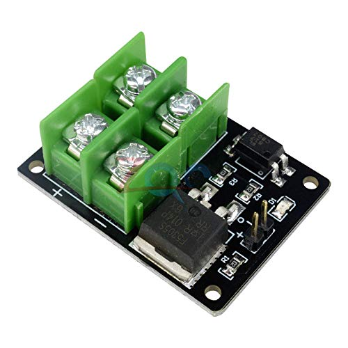

I've recently built an arduino project of my own design. It charges and discharges batteries and give Ah and works out internal resistance.
I used a high side switching arduino MOSFET switch to connect and disconnect the battery / load. It all seemed to work well.
However (there's always a but!) If I connect a 1.5V battery, the MOSFET fails to switch on / conduct properly.
I only have limited technical knowledge of MOSFETs, but even with 5V PWM applied to the gate, should the FET be able to conduct low voltages below 1.5VDC?
any pro (or non pro) advice would be food for thought. Kind regards
Dan

It's tough to answer without a schematic but in general, yes, a MOSET can conduct if the gate voltage is correct versus the source voltage. The drain voltage can be higher or lower than the source and current can flow in either direction with minimal voltage drop.
Your problem is almost certainly the Gate-Source voltage, or the MOSFET is damaged.

Thank you, yes I understand the difficulties without a schematic, but it's literally a tangle of wires hot glued to a breadboard at this time. Essentially I have a DIY more MOSFET module.
(sorry if links are not permitted) - https://images-na.ssl-images-amazon.com/images/I/41KoYvRT1tL.jpg
This is driven directly from a Uno pwm Pin9
I have a variable rheostat type resistor connected to the output and a battery across the input pins of the mos unit.
All works perfectly, but if I drop the input voltage to ~2 volts or less, no current flows. I also tried taking the pin low or high manually to see if it would switch on.
Confused as I would expect this from a transistor, but expected the mosfet to function as you described. Either open or close at low resistance. Maybe it is a damaged unit. Only have 1 - so something to check
back to the drawing board. (I don't have one hence no diagram ;)

It's the F5305S. On reviewing the datasheet I noticed data with: VSD Diode Forward Voltage ––– ––– -1.3 V
does this suggest the MOSFET drops 1.3V across it like a diode? If so I'm surprised it's worked as well as it has so far.

The Fet module has an opto-isolator input with a 3V minimum voltage (it has two series LEDs) and an ordinary P-Channel Mosfet.
The datasheet of the IRF5305 Mosfet shows an ordinary P-channel Mosfet with a maximum Vgs threshold voltage of 4V for it to conduct only 0.25mA and a Vgs of 10V for it to fully turn on.
The entire module can be replaced with an IRLxxx N-Channel Mosfet that turns on fully with a Vgs of 5V. I would use an IRLZ44 Mosfet that has an on resistance of only 0.025 ohms maximum when Vgs is 5V.
No. That data is the voltage drop across the IR LED inside the EL817 optocoupler. As Audioguru again mentioned the module requires at minimum 3 volts from the Uno to switch but it also specifies a minimum input voltage of 5 volts.

Correct, that's the voltage drop across the reverse P-N junction diode or body diode as it is also called inside the mosfet. That doesn't mean you are loosing 1.3 volts across the mosfet.
It's because of the component values on the module.
