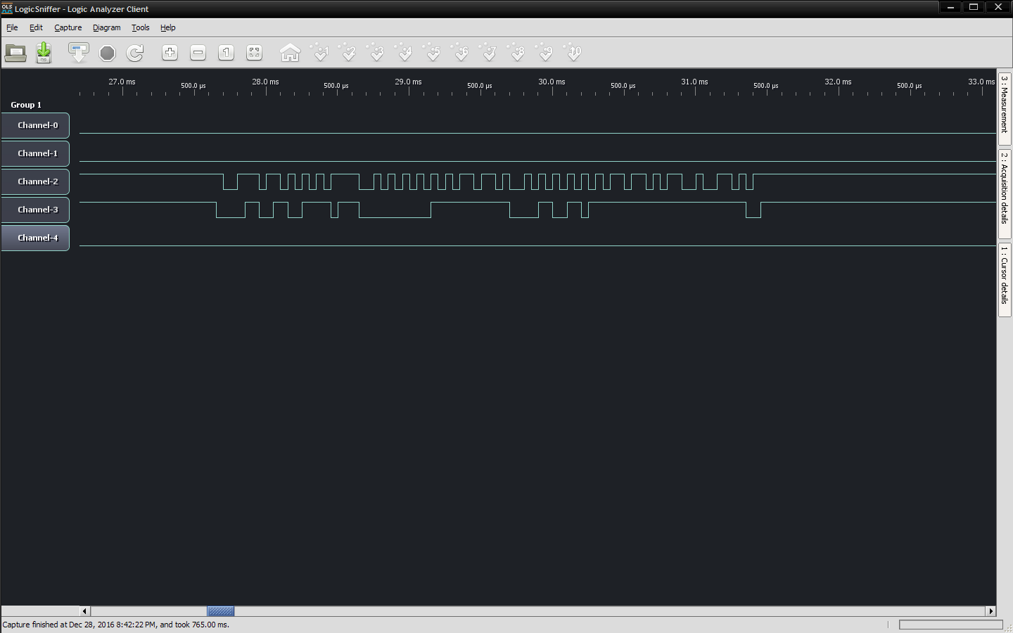

I received the Bus Pirate and confirmed that I have the B version of the chip (the correct version).
So I analyzed the i2c signal from the PIC chip, and this is the result I got in the software:
Does it look normal to you? The i2c analysis says there's a bunch of errors. It is possible I just don't have the software setup properly because I can only get it to capture 1/4 of the time (it seems if I'm lucky and press capture at the right time, that' when I get a result.)

Here's what I get out of that.. I don't know what it all means in the grand scheme of what you are trying to do. Sorry for the bad notations.. by the time I got finished looking at it I didn't want to redraw it.
In a nutshell,
The master issues Start, then a write to slave address 6Eh. The slave ACKnowledges.
The master sends 7Dh and the slave ACKs indicating it got the data and the master can continue.
The master sends BFh and the slave NAKs indicating it wants no more data.
The master issues a stoP to end the transaction.
Despite the potential issues, it looks like the master wrote 7DBFh to the slave at 6Eh. That could mean 'set the register address to 7Dh in slave 6Eh and write BFh to it' - depends on the slave but a set of 8 bit registers that are written individually could account for the slave's NAK at the end. Does that fit with what you expect? If not, I've noted some potential issues to think about on the sketch including a suspicion that the analyzer is missing things e.g. SDA transitions with SCL=1 and different SCL times.
Good luck!
EDIT: the first data byte is 7Dh, not 7Bh. Sorry for any confusion.

The previous shot showed writing to a slave at 6eh. What address do you expect the slave to be at?
Of note: 6Eh is frequently the default address for devices that accept some address-setting protocol. The master sends a request to 6eh and all of the slaves at the default address reply with a unique string. Only one will make it through, the others will be arbitrated off the bus. When the unique ID string is received, the master then sends a 'set address to xxh' command to set that slave to xx.
Can you post another shot - like or quote so I'll get an alert.

I have no idea because I had it set up to scan all slave addresses to find the correct one. Anyway, this is beside the problem.
I have likely found the problem. I was able to read/write the device at the correct slave address (the one in the datasheet) using a different PIC that has hardware master I2C. The PIC that I was using before had software I2C master only (using the mikroC library). Apparently that doesn't work with that particular device (unconfirmed).
I am now making a board with the better PIC, so I'll see what happens.
The device itself also has the peculiarity of responding on all addresses unlike any other chip I've tried. This made the debugging process harder because I assumed the problem was with the IC or the wiring of the IC, but not the PIC.

Wow. That is.. unusual. It is also out of I2C spec - maybe they screwed up and that's why they call it 'modified I2C'.
If you are sure that it is ACKing multiple addresses (by looking at the busses with the Logic Analyzer), that is weird. The default address when SEB=0 should be 0101011 (sec. 5.1 of the datasheet). That makes the slave address 2Bh or 56h to write and 57h to read depending on how you prefer to think about it. I believe the PIC wants SSPADD to be 2Bh and let it figure out the read/write bit. The QN looks like it wants the address right-justified too, based on the description for the DEV_ADD register 02h on pp28.
It looks like the slave address setup goes like this:
Set SEB=0 to make 2Bh the default address.
Write the desired slave address to register 02h (DEV_ADD).
Set SEB=1 to run at the new address in register 02h
Note that on power up the default address is set to 2Bh so SEB is don't care until you set the new slave address. After that, set SEB=1.
When you pick your slave address, stay clear of <14h or so. I2C defines a set of reserved addresses down there and some PICs want those left alone while others don't care. Which PICs require that restriction is not particularly well documented.
Interesting that MicroC's libraries didn't work but the uCHIP master did. MicroC is bit-banged and uCHIP master is hardware generated. I've used both successfully and without too much thought, even. It shouldn't be that sensitive.
I did note on your posted logic analyzer image (at the *) that SDA cycled while the clock was high. That shouldn't be an issue with I2C but maybe this slave doesn't like that and that's why MicroC failed and the hardware uCHIP master worked. It probably doesn't have those stray transitions.
