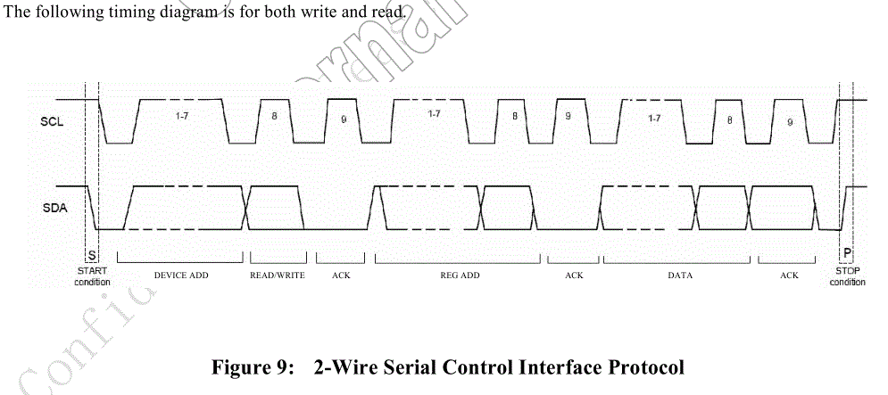

So I've been trying to get this i2c controlled fm transmitter chip working for a while and I was loosing my mind. I contacted the chinese company that designed it and they eventually showed me that the i2c protocol they use to control the chip is not actual i2c. I have two diagrams that show the difference. Does anyone know what this is called if it has a name and if there is a software library for it somewhere? Thanks!

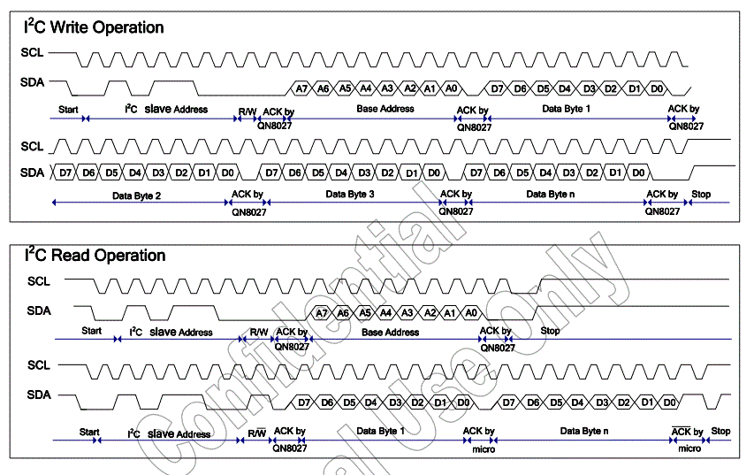

Here is the normal i2c diagram:
Here is their modified one:

Well, it looks to me like the SCL line is held high for seven bits sometimes instead of alternating high/low for every bit.
That's nonsense. The dashed line is an indication that SCL performs it's obvious function so that the diagram can be contracted. Next theory.

12,625
No, those parts of the line are dotted not solid. They have just condensed the drawing by not showing all the clock and data transitions.
It looks like normal I2C to me.

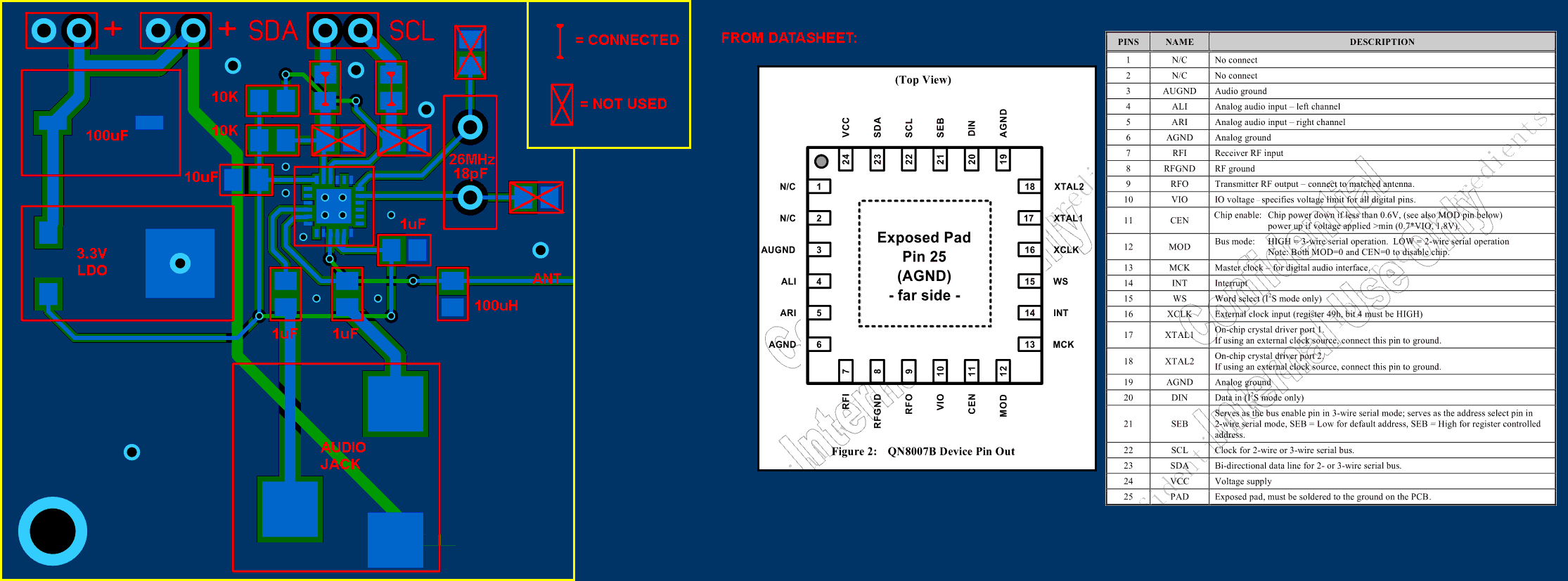

Here is a schematic. Do you see anything wrong?
You have to right-click and view image to get the full image. Normal click expands it wrong.
BTW thanks for the help.
*100uH should be 100nH

You have 10k pull up resistors on SCL and SDA which is higher than usual (4.7k) but probably OK if the wires are very short and the ground connection is good and short.
Synaps3
Joined Jun 5, 2013
99
I also tested 3.3K there.
(FYI: Ignore the green line going from + to the ground of the audio jack. That's connected to something else.)
Also caps on the crystal are not needed because they are integrated in the chip.
