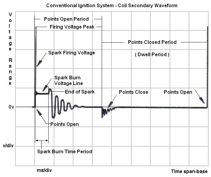

I have included a Spice schematic of my circuit as well as a trace profile for review.
The question I have is that I am not quite sure why the left side of the trace, square wave, looks like the charging of a capacitor even though there is no capacitor in the circuit. This scope trace is taken at -A- as seen on the schematic at the collector of the NPN (BC337). The 350v source that feeds the 2 zener diodes(100v, and 20v) is what I am using for the simulated voltage feedback from a 8mH coil primary Spice_4.pngafter it has been switched off and I am clamping it at 120v w/ the zeners. I know I am in saturation w/ the BC227 and I am able to read the signal w/ the microcontroller at -A-.
Could someone please explain to me why I am seeing this and a way to fix this low to high part of the trace to resemble a more pure square wave.

Did it occur to you that zener diodes might have some capacitance associated with them? Also the transistor model will have capacitance between the elements: base-emitter and base collector as well as a Miller capacitance if it is used as an inverting amplifier.
The turn on of a power supply if it has a finite rise time can look like a pulse. That trace looks hand drawn. How about a trace from the simulation.

The 350v source that feeds the 2 zener diodes(100v, and 20v) is what I am using for the simulated voltage feedback from a 8mH coil primary after it has been switched off and I am clamping it at 120v w/ the zeners.
The way you've got those Zener diodes connected, in series with the 350V source, they're not going to be doing ANY clamping. Google "zener diode clamping circuit" to see how it should be done.
Assuming that by "low to high part of the trace" you mean the slow risetime of the voltage at the collector of Q1 at the point marked "A", you cannot expect a fast risetime with the circuit you've designed. You have a means to turn Q1 ON via the pulse coming in through your resistors (why 4 of them, by the way?), but no means to force Q1 to turn OFF, other than letting its base charge and the charge in its base-collector Miller capacitance slowly drain off through those same resistors once the input pulse ends. Try connecting a 1.5 kΩ resistor between the base and emitter of Q1 to add a better turn-off path for the base; that should help a little.

be aware that the spice BjT model does not simulate the 6..8V reverse breakdown of the BE junction !!! = you need to put a forward rectifier in series with your Zeners

Please find a sample, marked in red, of what my idea for this circuit is attached to this post.

The transformer is actually an ignition coil w/ 8mH inductance. This coil has 14.3v input on the primary side and is clamped to only 5.5A. The Coil - in the diagram from post #8 shows this ("Coil -" in the red section on the left") which then feeds into the zener diodes and the rest of the circuit which ends up at the microcontroller.
