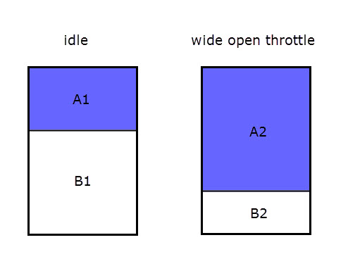

by the way if we check the below simple drawing
as they explain in idle less mixture ( A1 ) enters the cylinder. but is that remaining volume ( B1 ) a perfect vacuum ?
also when it's in wide open throttle more mixture ( A2 ) enters the cylinder. is that "B2" volume also a vacuum ?
coz if "B1" or "B2" are filled with air it will imbalance the mixture ( air + fuel ) created by the carburetor. am i right ? thank you :)

You can think of it that way. The combination of air/fuel mixture "A1" and vacuum "B1" is just a partial vacuum at the full cylinder volume. The fraction of the air volume (at atmospheric pressure) over the cylinder volume is called "volumetric efficiency" and is stated as a percentage. At idle it might be 5 or 10%, and at full throttle and near the torque peak, it approaches 100%.

To stop the increase in RPMs you close the throttle plate which lowers the airflow which lowers the air-fuel ratio
The closed throttle plates reduce the airflow which also reduces the fuel, but the A/F ratio should stay close to stoichiometric. The engine power is controlled by reducing the mass of air/fuel mixture, not by reducing the A/F ratio. A richer mixture doesn't always make more power. Too lean is usually bad though, since it doesn't always ignite and you get a "miss". This is where fuel injection shines, since it can directly and accurately control the A/F ratio. Carburetors will vary more, so they are typically set to the "rich" side.
this is the answer i was looking for. it's the mass not the ratio :)
i'm kind of familiar with the carb idle, mid & main circuits. so i always wonder why manufacturers make a lean mixture at idle and rich at WOT. well it's misconception i think.
it's the A/F mass not the A/F ratio as you said. coz practically we can make a good mixture in both idle range and WOT using pilot screw settings, idle/main jets etc. thank you :)

"volumetric efficiency" is the word i was missing. thx to @Chris65536 . found some explanation in youtube and as said above it's the fraction of ;
actual volume
_________________ %
theoretical volume
apparently the sudden movement/speed of the piston creates that vacuum which will reduce gradually as we open the throttle. means more % volumetric efficiency at WOT.
