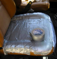

The driver seat cushion on my vehicle torn from 25 years of butt sliding in and out. Spent a couple of hours strolling the wreck yard and extracted the passenger seat cushion of a BMW closely matching size, material and color needed.
No upholsterer involved.
Swapped. Am happy.
