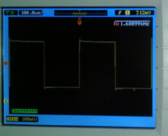

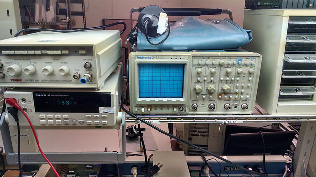

What causes these spikes on this waveform
ian field
Joined Oct 27, 2012
6,536
X1 or X10 probe? If X10 probe is it correctly compensated?
The flat top of the waveform is only about 3.9V. Why is it so much the (assumed?) 5V PIC supply. Is anything else connected to the PWM output (other than the scope probe)?
You beat me to it - it could simply be the compensation capacitor adjustment on the scope probe.
Run of the mill CROs often had a diode clipped sinewave to approximate a square wave. Sometimes that was good enough to adjust the probe compensation by.
If I couldn't adjust it out with the compensation cap - I'd double check with a TTL clock module, they used to be fairly chunky modules with a pin footprint that fit a 14-DIL socket. They started turning up as 8-DIL packages on PC motherboards for a while.

DickCappels
Joined Aug 21, 2008
10,660

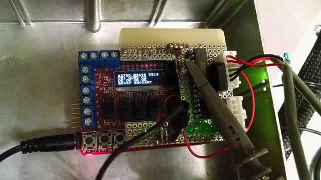

It sure looks like a scope grounding issue.
The overshoot occurs on both the rising and falling edges, but the scope is probably missing some of them because they are very fast. Perhaps something in the setup can make both appear consistently. The first thing that comes to mind is to trigger on the rising edge then speed up the timebase for a better look at that edge. A similar inspection of the falling edge should make it all clear.
My Tektronix scope allows switching the display mode between dots and vectors. Might be a good idea to verify that your scope is not in "dot mode" if it has one.

Spikes on the signal on every edge.

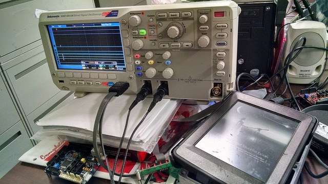

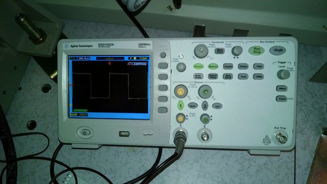

Fair enough, and and after seeing your pictures with the Tek MDO3k and the Agilent DSO1022A I can even see why you prefer the 2465 and why you said that the digital stuff gets in your way. I had a MDO3054 myself, and it's really an awful scope (idiotic UI, slow as molasses processing, locks up when doing something demanding, like pretty much every Tek DSO). It's a real shame that Tek never figured out how to do a digital scope properly, or their business wouldn't have been in pretty much constant decline for many years.
Anyways, as I said my point was that you don't need an analog scope to find out if what you see on the screen are artefacts or part of your input signal. Although the poor low-res screens of the old Rigol DS1000/Agilent DSO1000 can sometimes present a challenge.
16,340

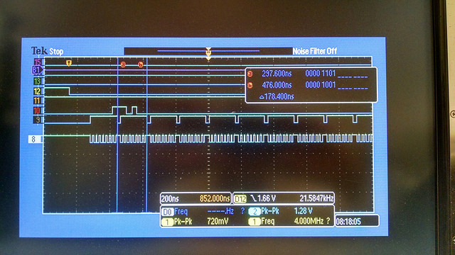

I spec'd the TEK MSO mainly for the embedded signal decoding and external VGA capabilities and you're right as a pure scope it's a dud when matched to the quick operation of a older unit like the TDS 220.
