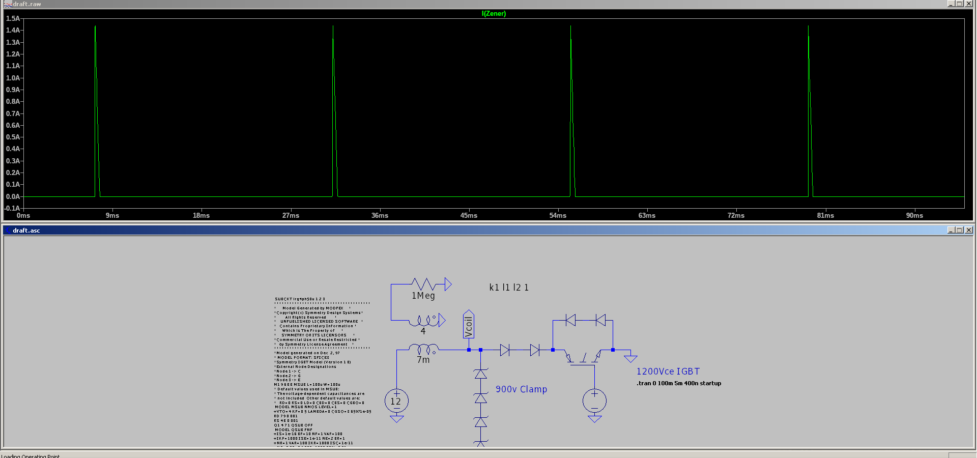

Were is the high current coming into the zener diodes
pager48
Joined Nov 25, 2018
161
The coil voltage is below zeners clamp but with zeners attached to circuit node zeners conduct without clamping voltage being reached.
How can the clamp be adjusted to conduct only when coil voltage exceeds clamp voltage?
Unclamped:
Clamped:
AlbertHall
Joined Jun 4, 2014
12,660
A zener diode in the forward direction conducts like a normal diode - about 0.7V.
You need to connect another three zener diodes in series with the existing three, but the other way round.
See the double diode clamp circuit here.
