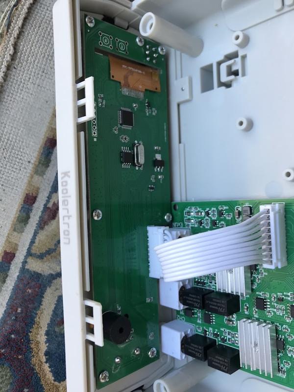

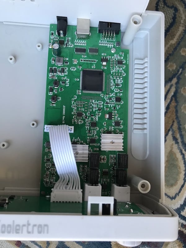

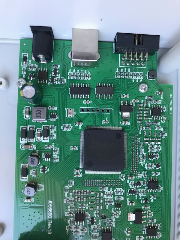

Inside the Koolertron :
MisterBill2
Joined Jan 23, 2018
28,614
OK, good resolution photos that do not show device type numbers AT ALL!! What I see is an instrument with an attractive PCB, and a LSI processor to drive the display.
None of that tells me about what the circuit is or how it works, except that much of it is digital.
To discover anything about amplifier distortion you will meed a dual trace scope to display both the input and the output of the amplifier at the same time. ALL of the differences in shape between the input and output , except the size, are from distortion.
