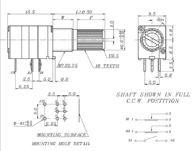

EDIT: It just popped into my head again that when you lower the input volume using a different potentiometer (between source and amp) the hissing is still audible when you turn it up to max gain/volume. So it can't be a issue with the potentiometer being broken, right?
hmmm, so the volume knob might be broken in that case? any way I could measure that using a multimeter, don't have a scope (yet) unfortunately. It's a 2 channel B50K potentiometer like this one:
aliexpress.com/item/32860108972.html?spm=a2g0o.productlist.0.0.241792ae2E0m1U&s=p&ad_pvid=202004151509157372195610265150004497405_6&algo_pvid=d98bdb46-f47f-40e9-af61-15c22ef011cb&algo_expid=d98bdb46-f47f-40e9-af61-15c22ef011cb-5&btsid=0b0a187b15869885551345574eaab9&ws_ab_test=searchweb0_0,searchweb201602_,searchweb201603_
Audioguru again
Joined Oct 21, 2019
6,826
All 3 pins are connected on a volume control.
A volume control has the resistance connected between the signal input and ground. Then the slider slides up towards the input to make higher volume or slides down towards ground to make less volume.
