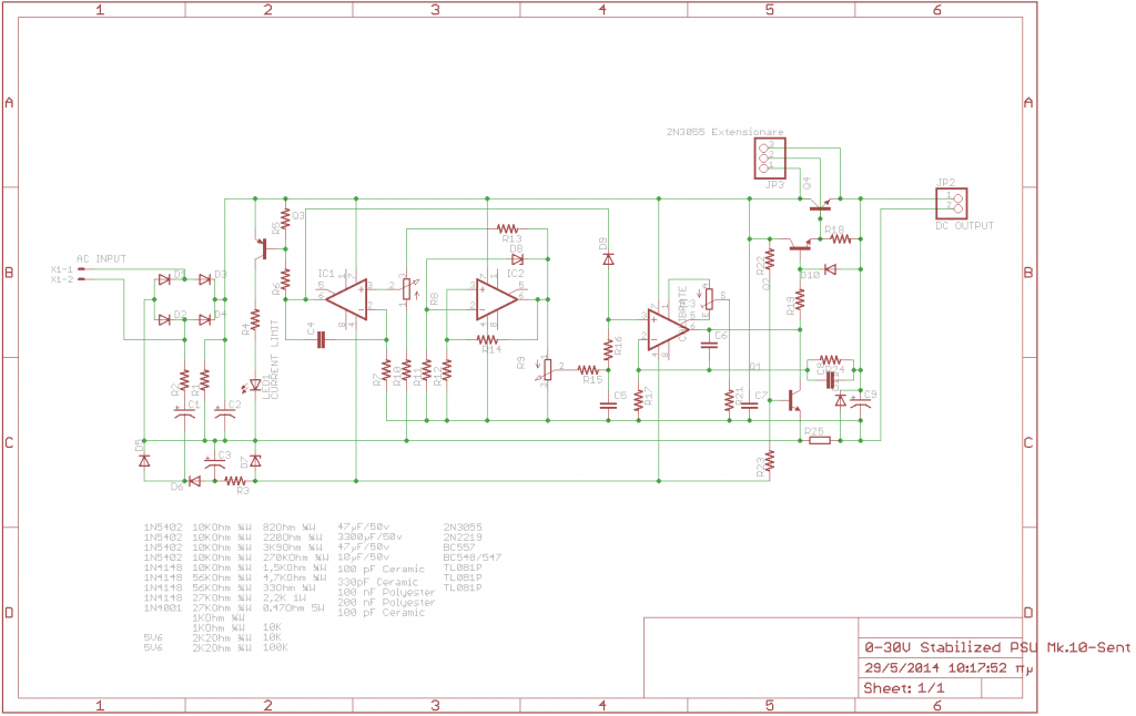

Hello , Am wondering if anybody can help me please. I have been looking for a (ideally) AC/DC variable power supply but not too expensive ,
Ideally for 0 volts to about 35 volts after looking around my head was spinning with all the different types but i stumbled across a DC 0-30 volt kit to build (which looks straight forward to build) on ebay
http://www.ebay.co.uk/itm/Regulated...V-2mA-3A-Precision-Variable-Lab-/132104143924
so with it been cheap and thought it i would get me half way to my goal ..
Problem i have is that after i assembled it, and checked it , its not working , i got 20 vac going in (it does say 24 vac tho but would this matter?) at the fan i get 24 volt but the output not power at all . could anyone give me any advice other that putting it in the bin . i have been i touch wit the seller but they don't know anything about electronics they just sell them (am guessing they buy them in from china or Hong Kong) they asked me to take it to a specialist to see if they can sort it , i will be getting back to them if i cant get it working to get a refund i just thought i would see if anyone has any experience with this type of power supply first .

Do you have a schematic?
Using 20VAC instead of 24VAC, would reduce maximum output voltage by 4*1.414 volts.

Have a look at the picture of it on the advert ( hover mouse over pic to enlarge) then very carefully check that all the components are fitted exactly the same, (colour codes, polarities etc) I built a kit of an audio bargraph indicator for an amplifier and the assembly instructions had several mistakes.

hello i have just been doing some digging about on the net for schematics for this circuit, I found this video on you tube showing someone assembling a kit and if you fast forward to about 17 minutes he puts up a schematic of his circuit . The circuit board and components look exactly the same as the one i have apart from the small diodes (4148 , 5v1) are shown printed the opposite way round ? the tracks on the circuit boards are exactly the same as i see ?? and the guy in the was using 24vdc so his didn't work first time , i am using 20vac cheers Mal

There's your problem then, you haven't got the Negative voltage on C3 of 5.6V, C2 should be at least 15V.

You need to check the power supplies first, Ac in, Dc across the capacitors C1,C2,C3, check polarity of the diodes D1,2,3,4,5,6,7

Hiya Dodgydave , Sorry it taken a while but i had computer problem so couldn't get back to you with the out come .
The polarity on all diodes are correct as the printed circuit board indicates, and the ac power in is 20vac . The DC power across C1 is 5v ,C2 9.2v and C3 25v.
This is very frustrating as i have got over everything three times and checked all joints and all seems ok .
