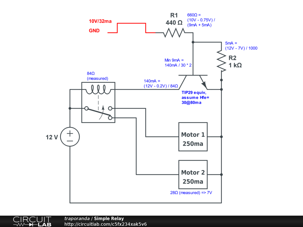

@MisterBill2 Ok I think I get it and made the following diagram (live link) of what I've understood. I'm quite unsure of the calculations and whether the 12V really goes to the COM of the relay. Feedback generally on this diagram and the calculations very welcome. I'd still have to find the actual transistor to use, but this at least would give me the template of calculations. Please forgive the many conventions of circuit diagrams I'm certain to have broken as these concepts are all new to me.

YES, that is the circuit that I was describing. The only revision I suggest is changing the value of R1 to 430 ohms, because that is a standard value, while 440 is not. And with the voltage rating of the transistors and the relatively slow switch off of the transistor you will not need a diode on the relay coil.

you need a diode (parallel) across the relay coil with the anode to the positive and cathode to the negative side, unless there’s one built into the relay. Without this diode you will burn out your transistor. You can go with a smaller transistor. 20-30 mA is in the General purpose range. Check out the 2N2222.

Wolf, I deliberately selected a higher powered transistor, with a higher voltage rating and a higher current rating, for this application with a slower switching off time so as to avoid needing that diode. Also, the transistor selected is mechanically simpler to deal with and only costs a small amount more. On many occasions it is better to allow a bit of margin instead of selecting a part that only just meets the assumed requirements. Sometimes reliability and robustness are more important than saving a few cents. I am fully aware that is in direct opposition to the way consumer stuff is designed, but really, for an application where reliability is important it does matter.
AND, in a system where the output voltage is an analog value, the rate of voltage change is much slower, making the inductive spike MUCH smaller.

if reliability matters, I would put that diode in... TO-220 package for switching a little solenoid is like using a V8 on a lawnmower. Inductive kickback from a collapsing coil can be over -100V from that little coil. It's not about over-sizing the components, it's about good design and knowing what is happening.
Basically opening that circuit causes an airgap to occur and with an immense resistance across, as you know V = IR and that current stored in the coil needs to dissipate so it reverses and the voltage rises until you ruin your transistor. Try it... it's fun... if not, you're degrading the transistor and it will eventually fail. TIP29 is only rated for 40-100 depending on which version you got. As the component resistance at off is quite high, the voltage will keep climbing until it punches through.

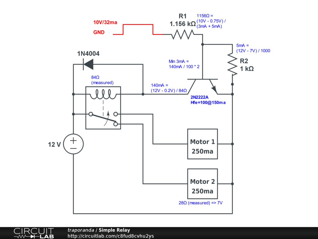

So it sounds like adding the diode isn't going to hurt. Kindly see below (or link). Also I switched in 2N2222A because that's available at an electronics place nearby. The spec sheet on it shows Hfe @ 150ma of 100, which significantly increased the size of R1 to 1,156Ω (so I rounded to 1,200Ω which my store has in stock). That doesn't sound right though? And how do I know what wattage to pick for the resistors? If I use (10V - 0.75V) * (1200/1000) I get a crazy number.

The value of your pull down resistor is too low.
And you need to use a gain of ten to twenty to get a 222 into saturation.
Change R2 to 10k and R1 to 1k.

With a an Hfe of 100 and a collector current of 140 ma, the base current would be 1.4 ma, not much. A bit of excess base drive will assure adequate saturation, and you need to look at the minimum Hfe, not they typical or average value, so that it will work with a worst case transistor. So the 1.2K resistor will be close enough, and you can use that for the base pull-down as well and only need one value for the project. (Brown red red.) AND STILL, either of the transistors that I suggested are physically much more rugged and durable.

Hm so I got the the 2N2222A transistor, 10KΩ and 1KΩ resistors (1/4W), and 1N4004 diode since a local electronics store had those in stock and I was excited to give it a shot. Unfortunately, it didn't work out! But I have a feeling it's more than because the transistor is underpowered. To test it, I wired the relay so a pump was powered when the relay coil wasn't energized. Then I connected an alternating 0V/10V signal at 3 second intervals. Instead of the pump turning on and off every 3 seconds, it stayed on the whole time. I took these measurements when it was wired up and plugged in with the signal voltage alternating between on and off:
  • Voltage going into R1 with signal off was 0.83V and with signal on was 9.96V
  • Voltage going out of R1 with signal off was 4.80V and with signal on was 9.75V
  • Voltage across the C and E sides of the transistor was 11.70V when off and 12.00V when on
  • Voltage across the relay coil was 0.06V when off and 0.37V when on
Sounds like I wired something wrong? I checked ten different ways. But regardless, it sounds like I should:
  1. Switch to a TIP-29 transistor
  2. Assuming its Hfe=100@140ma, replace the resistors with 1.2K (1/4W)
Thoughts on the voltage measurements above? Great to see the back and forth; I'm having fun learning from you all.
