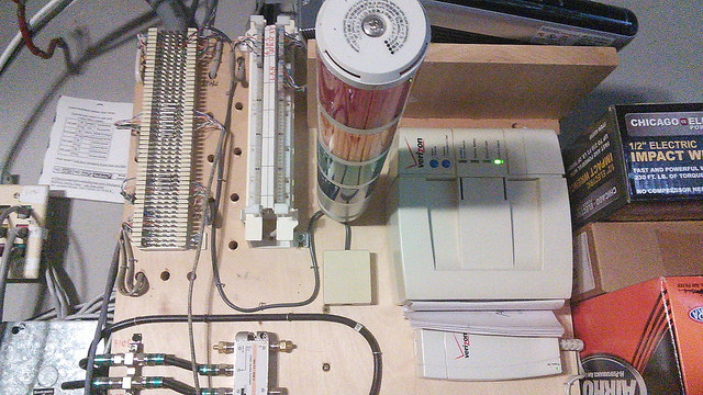

FIOS should come with a UPS for the fiber interface. I installed a wood panel to mount the UPS and punch blocks in the house for the installer to use.
My install was Internet only cat5 but I have dedicated VOIP and Xlink boxes for the cell interface linked to the house hardwired phones connected to a couple of large online UPS (Toshiba 1400SE) systems that run the main computer system, phones and backup lights.
I have a couple of old Toshiba 1400SE ON-LINE UPS systems but any good industrial quality on-line unit should work.
