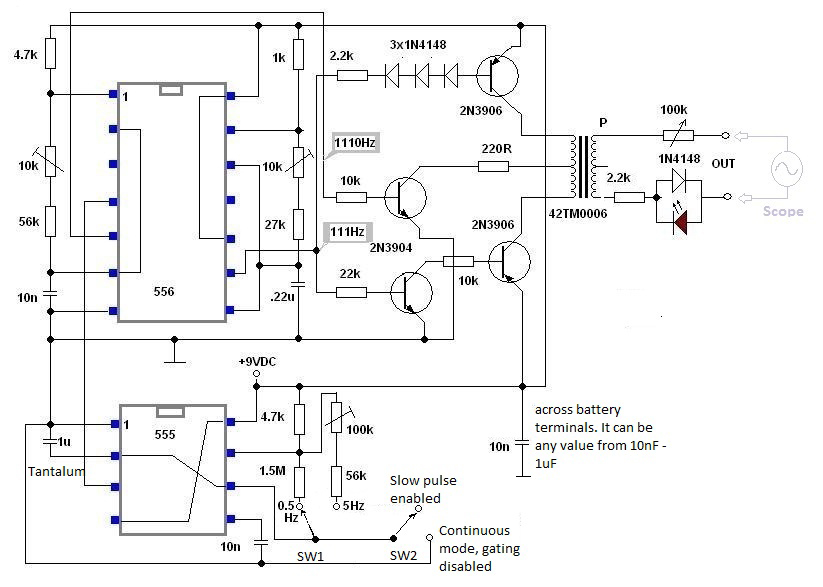

Hi all! I would like your help with something I'm designing...Well, actually transforming. I'm trying to simplify the circuit above into one that would completely omit the transistors and transformer parts.
The reason why this is needed is because this transformer is now obsolete and can't be found in small quantities anymore and because transistors make the circuit look complicated, where in my opinion a single opamp could be used as a two signal mixer. As I understand, the role of the transformer there is for the two signals combination, along with impedance matching and current increase to the load while keeping current at minimum levels on the transistors side.
So, what do you think, is my thought correct? I was thinking about two signals mixing using an opamp and then using a T-network to match the impedance. And also replacing the transistors with a 2n7000 just before the T-network.
The needed values for load are: Impedance: ~1000ohm, Current: ~15mA adjustable. Any help would be much appreciated.

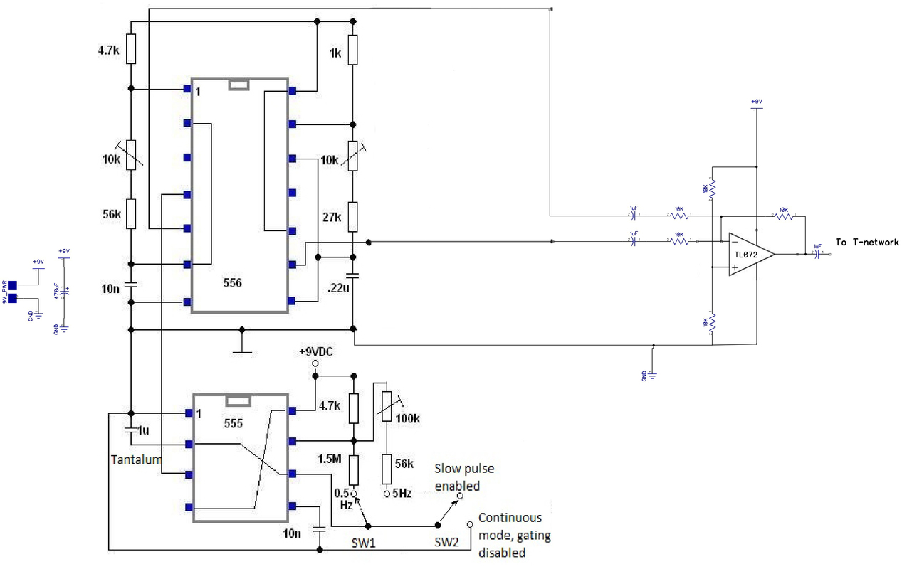

Ok, to be more specific, this is what I'm thinking about...Could anyone help me please?
You probably need to look for mixer chips based on the Gilbert cell - although some types are designed to drive a CT transformer with complementary outputs.
You can probably design a resistive loaded one for a specific output impedance, study the appnotes for more info.

Thank you very much for your advice Ian! I took a look at the Gilbert cell but it seems to me that using two differential amplifiers and calculating values is a little bit more complicated than using a single opamp...It is just two signals in audio range so I think using a Gilbert cell would be kind of overkill for this application...Could you please tell me if the above circuit would work as it is or even better with an LM386? I only know amplifiers theory, have given exams on them but it's been a long time since and I have not designed such a circuit myself in the past, so any help would be much appreciated...
Also what do you mean by resistive loaded? Since we have different impedance at 555-556 outputs and load. How should I match those two different values by only using resistors? Or did I get it all wrong?

The LM386 is a power amplifier - some people have dubbed it; "the cockroach of audio amplifiers".
For audio work - suitable transformers may not be extinct. Its been a while - but last time I looked; Maplin had the LT44 and LT700 push-pull driver and output transformers. Its possible to use one of these in a diode ring mixer for audio work - you need ham radio magazines to find articles, apparently there's a load of 73 magazine on archive.org

An additive mixer......or a multiplicative mixer?
Are you adding voltage....or beating frequency?
Do you want a composite output or a discreet output?

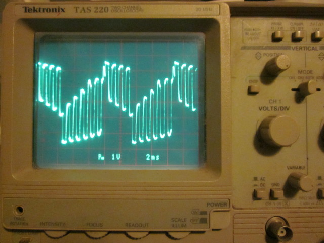

BR-549 I really have no idea man...Until know I knew the "multiplexing" term, done the old fashioned way, with a signal transformer and RF impedance matching using baluns. Anything else is new to me. If it is of any help, please take a look at the 1st schematic above and also I'm posting the output from the 1st circuit above: 1100Hz and 111Hz modulated by a third frequency (I think 5hz).
Edit: Ok it seems I knew what you mean but not in English (since it is not my mother tongue). Well, I need an analog output, two frequencies multiplexed together, modulated by a third. I don't need a digital (if this is what you mean with "discrete") signal for using it in a digital circuit or something.
About the others, I guess I'm not going after voltage adding but I'm not 100% sure if the transformer in this particular circuit works this way or not...
