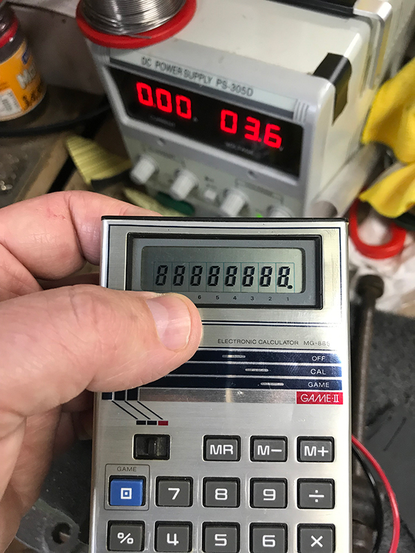

I've got an old Casio game calculator (MG-885 ... the 8-Attack game) that works fine, but the top of the display is very light with the two standard 1.5v batteries installed.
If I boost the voltage (with a benchtop PSU) to 3.6v the display is perfect, nice and dark. Unfortunately since you can't get 1.8v batteries I'm a bit stuck.
How (if its even possible) can I get 1.8v from each 1.5v battery to have the display look like this all the time?
I've checked the components (there aren't many - capacitor and a few resistors) and they are all within range of a known good working calculator so I think it's just that the conductive ink (this uses conductive ink on paper to go from the circuitboard to the LCD) has degraded over time — the calculator is nearly 40 years old — and just has too much resistance these days.
Here's a couple of pictures - one with 3v running through it, and one with 3.6v.
