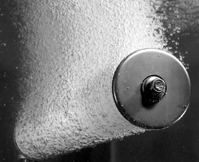

I think he pretty much has the basic concept figured out right from the get go. A tube with proper sized holes in it.

Perhaps a field trip to the local pet store is in order. Either by the TS or one of us helpful assistants.
I was researching a similar device, only to provide a wall of water drips. I found in the aquarium section, a device similar to the one being discussed. As I remember, it was about a 2' long, 1/2" diameter plastic tube. Air was center fed. The holes weren't Uber tiny; 1/16" comes to mind. A bit of math said the area of the tube would support 60+ holes to match the 1/2" cross-section. Less than half that would provide 1" spacing, with 1/2 the volume/area providing a buffer to even out the pressure.

But we all know the TS needs a fat header with lots of tiny holes. None of us can define fat or tiny. All will be revealed with a handful of simple experiments, with care taken to control pressure and flow.
