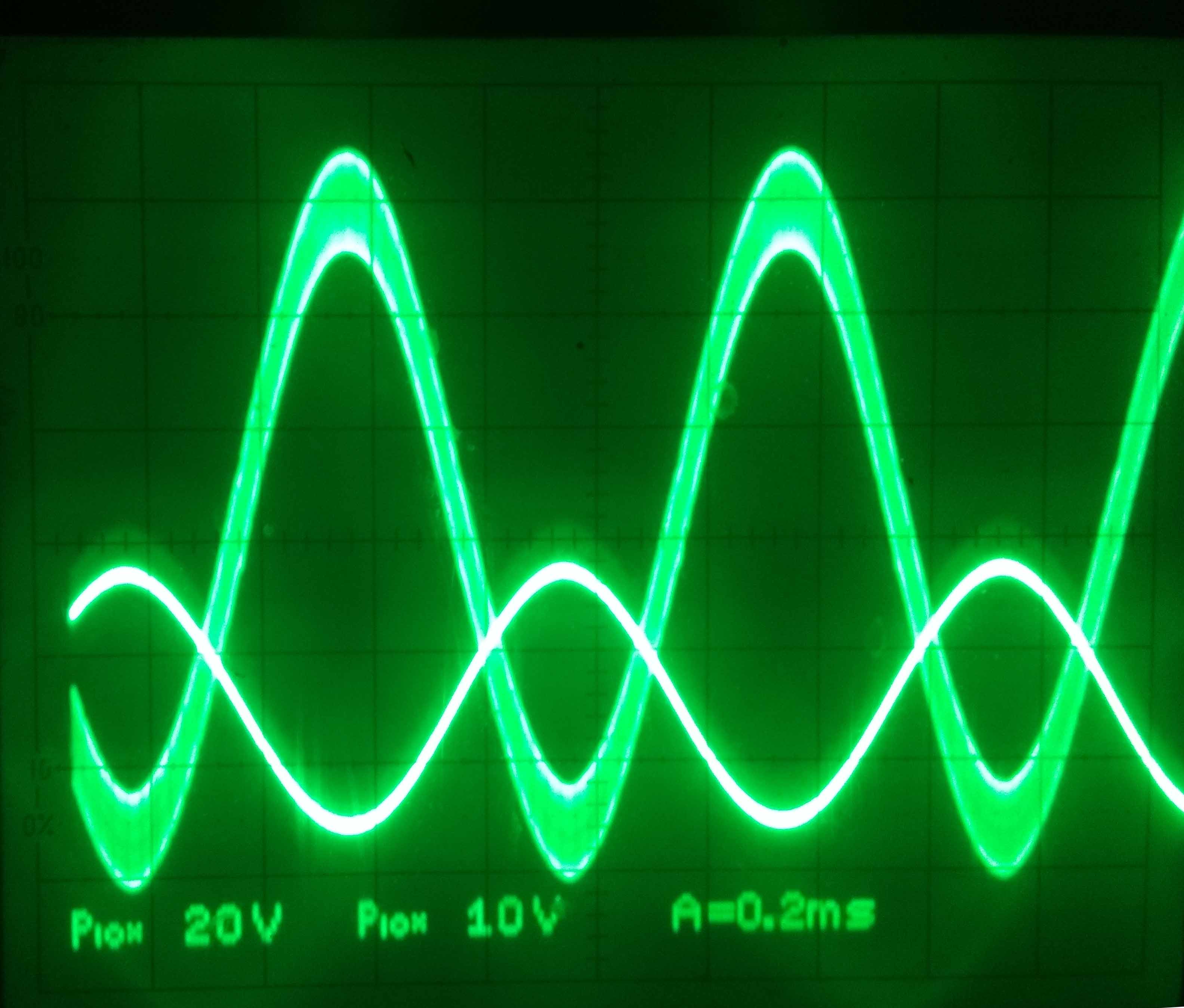

I have recently purchased an amplifier module based on the TDA8950 device from eBay and am experiencing distortion at all output levels.
(eBay: http://www.ebay.co.uk/itm/252534422644)
The module includes a bridge rectifier and smoothing caps and only requires a (stated) 22V-0-22V AC supply.
The circuit board does not appear to have any form of voltage regulation and according to the NXP spec sheet the device can handle a wide range of supply voltages from ±12.5 (min) ±35 (typ) ±40 (max).
(NXP spec sheet here: http://www.nxp.com/documents/data_sheet/TDA8950.pdf
I have a been powering it with a toroidal transformer supplying ±30V AC.
When I first set it up on the bench I connected it to a small set of 4.8Ω speakers and fed it with a line level signal from a CD player. At all volume levels there is distortion.
If I set up the amplifier with a signal generator producing a 1KHz test tone at 0.4V and drive 4.7Ω power resistors (or the speakers) and look at the input and output signals on an oscilloscope the output trace apears ‘fat’ when compared to the input. The output is not clipping - although that can be achieved.

Only thing i can suggest is the transformer is not giving enough current out, can you measure the voltage across the two smoothing capacitors, when you apply the signal, otherwise try using a dual DC power supply.

Can you determine if the distortion is at the PWM frequency of the Class D? How have you set up the oscillator frequency?

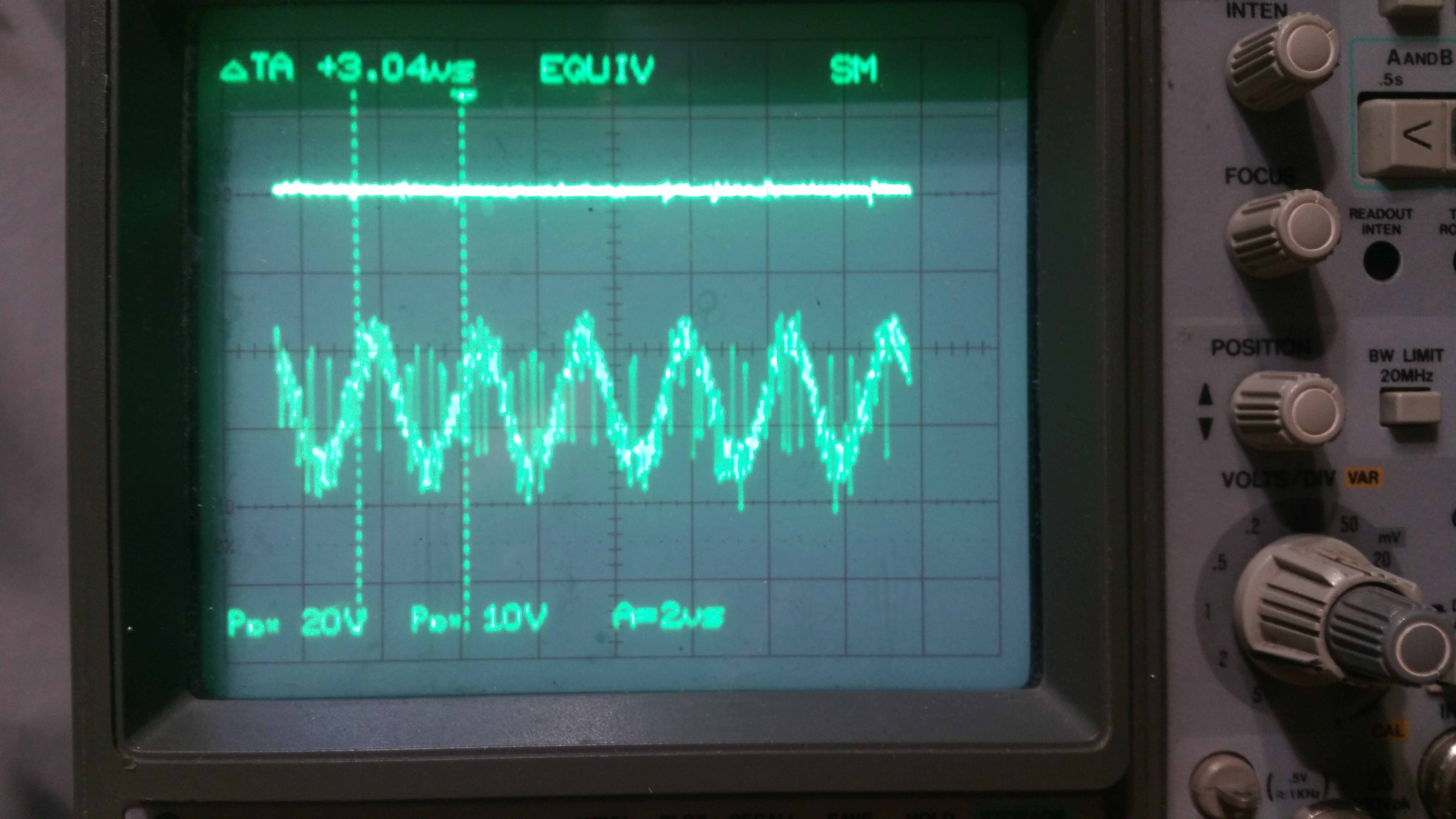

If you select x10 magnification on the scope you can see the 'fat' output trace is indeed made of a high frequency sine wave. I can't be 100% sure but I (think) I have measured a peak to peak time of 3.04 uSec . There is no user input to externally clock the device on the board and my assumption was it was self clocking. In the eBay description there is no mention of users having to setup an oscillator freq.

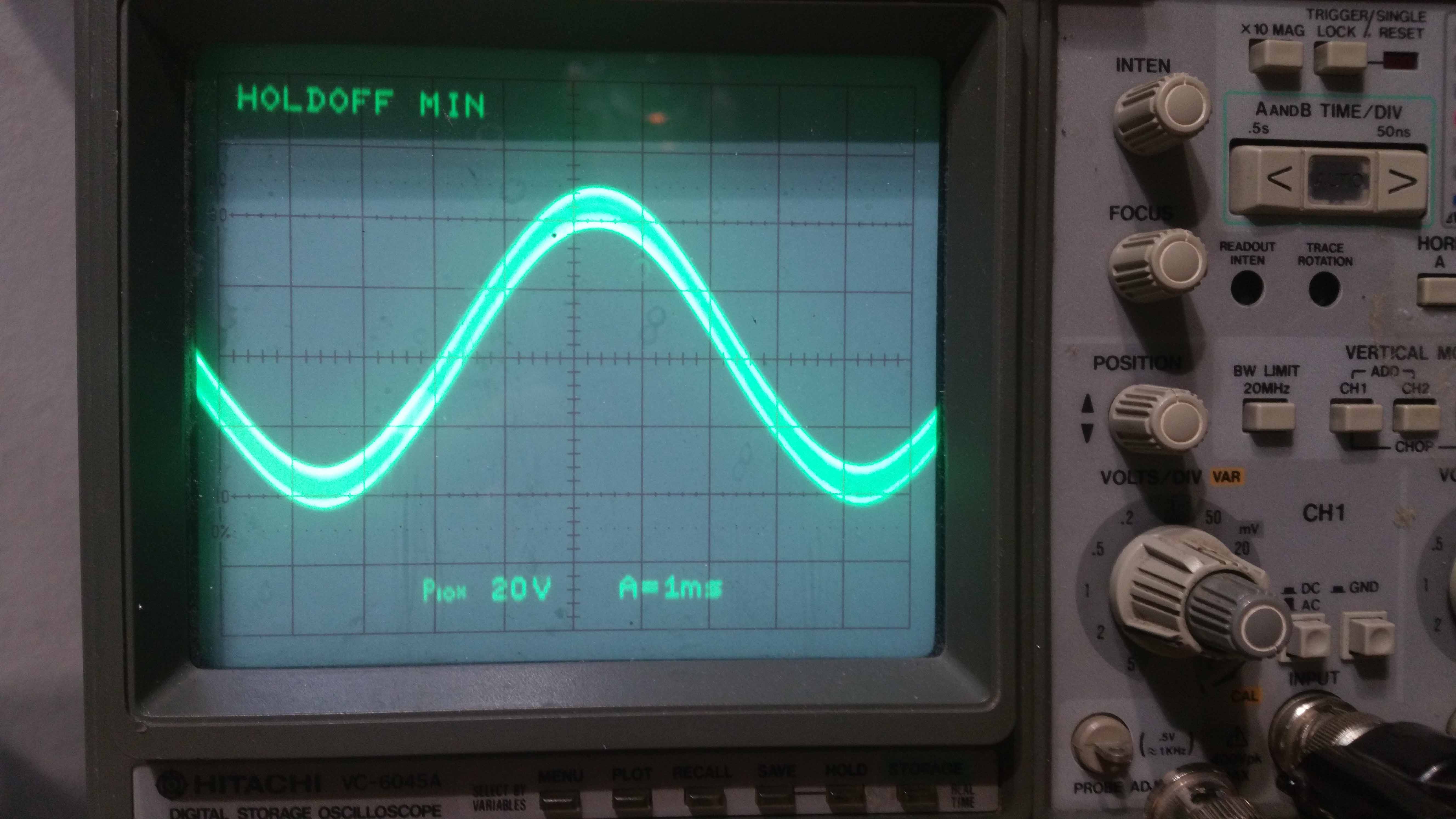

What happenes if you sweep the frequency from 150Hz upto 20Khz??
Think your psu is Too high voltage!!!!
Neville Thannhauser
Joined Dec 3, 2016
27
Hi Dave. The 2 traces below display 120Hz (top) and 21KHz (bottom).
Iv'e also swapped the mains transformer for one that outputs 21-0-21V to see if that made a difference - it did not.

The "fat" waveform is the 345kHz PWM signal. This is normal. Your speaker cannot respond to such a high frequency.
My guess is the apparent distortion is from something else.
