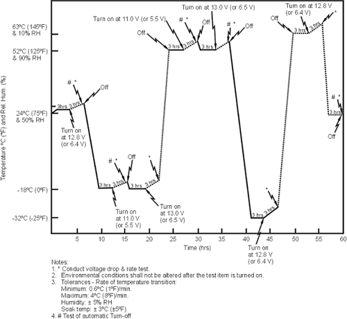

The flash rate and intensity for a modulator in the US as listed here are:
  • The rate of modulation shall be 240 ±40 cycles per minute.
  • The headlamp shall be operated at maximum power for 50 to 70 percent of each cycle.
  • The lowest intensity at any test point shall be not less than 17 percent of the maximum intensity measured at the same point.

And tested in accordance with this profile:
Conformance with the regulations drives the price UP.
I suspect the "requirement" to tap into the power side vice the ground side is so you can "modulate" either the high or low beams without modulating the other when both filaments are energized.

In addition to the "requirements" stated by crutchow in post #13, there are theses additional requirements.
d.The modulator switch shall be wired in the power lead of the beam filament being modulated and not in the ground side of the circuit.
e.Means shall be provided so that both the lower beam and upper beam remain operable in the event of a modulator failure.
f.The system shall include a sensor mounted with the axis of its sensing element perpendicular to a horizontal plane. Headlamp modulation shall cease whenever the level of light emitted by a tungsten filament light operating at 3000 deg. Kelvin is either less than 270 lux (25 foot-candles) of direct light for upward pointing sensors or less than 60 lux (5.6 foot-candles) of reflected light for downward pointing sensors. The light is measured by a silicon cell type light meter that is located at the sensor and pointing in the same direction as the sensor. A Kodak Gray Card (Kodak R-27) is placed at ground level to simulate the road surface in testing downward pointing sensors.
g.When tested in accordance with the test profile shown in Figure 9, the voltage drop across the modulator when the lamp is on at all test conditions for 12 volt systems and 6 volt systems shall not be greater than 0.45 volt. The modulator shall meet all the provisions of the standard after completion of the test profile shown in Figure 9.
