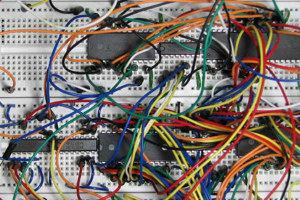

You have showed us your schematic. You have not shown us your attempt to breadboard it. If you don't have anything on your breadboard, insert the chips and connect just the power layout to the chips, every connection directly connected to positive and ground. Then post a picture of your breadboard.
This way we can see something other than words on this screen.
Remember, I only want to see the power connections to the chips.
I don't like troubleshooting a breadboard that looks like this, and there have been worse than this:
So do the job neatly.

Joe: this is my latest failed attempt, I am attaching the pictures. Let me know if you want any other info.

What test equipment do you have?
On edit:
If you have a DMM, check the voltages to ground on every pin of the chips and the transistor.
Record and post them.

IC 1 farthest from transistor Pin1=0v, Pin2=.160mv, Pin3=5.9v, Pin4=7.0v, Pin5=4.6v, Pin6=.160mv, Pin7=.156mv Pin8=7.03v.
IC2 closest to transistor Pin1=0, Pin2=.160mv, Pin3=5.7v, Pin4=7.0v, Pin5=5.02v, Pin6=.158mv, Pin7=.157mv, Pin8=7.03v.
Transistor TIP31 Base jumps from .005 to 000mv, collector .003, Emitter .000

You need to look how you have that transistor connected or that transistor might be defective.
Post a clear picture of just the transistor area.

C4 connects between the +V supply and ground. Those lines represent a wire ... and the dots represent a connection.
If you changed any connections, remeasure the transistor connections to ground.
I don't like the fact that the Q1 base is too low, it should be closer to 0.5 to 0.7 volts. I don't like the fact that Q1 collector is zero. It should be higher, possible about half the supply voltage or more depending on how your DMM samples the signal.
