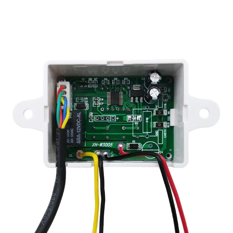

Sorry, total noob here.
I have this step down converter (attached) but I don't know which input and output pins/screws to use.
I'll be attaching this to the 2 output wires of a 220v humidity sensor, i then want to step down that voltage to 5v for my mini humidifier. If anyone could suggest which wires go where it would be appreciated!

That sensor looks pretty scary if it is the one that runs on 240V!
If so, I would consider not using it as the mains isolation is non existent as far as I can see. At least be VERY careful, and if you don't know what you are doing, don't do it!
Your humidifier runs on 5V so, a 240V to 5V supply is needed. An old phone charger is the easiest way to go.
But if yours is the 12V one, go for it.
You feed the 12V out to a buck converter..
On Ebay or Aliexpress, search for "dc-dc buck converter 5v"
Find something like this..
If you get the adjustable version, set it to 5V before hooking it up to the load.

I'm concerned with the mains driven unit as the picture of the PCB does not seem to have a real power supply so mains will be on all the cabling to some extent. A lot of cheap devices from places like that will not pass safety tests. It may be wise to use a 12V unit running off a "real" power supply in the interest of not electrocuting someone, and that is not to mention the real risk of fire.

It is a bit hard to tell. Is there any power supply markings on your unit?
Is your unit the same as the photo? can you post a picture of the insides?

The main concern with 240 VAC is it might hurt or kill somebody. Even if you insulated it well your humidifier which is likely to be wet in places may have 240 VAC on it, and wet or dry I wouldn't want something like that around.
If you "under volt" the humidity controller to a voltage that is safe for human contact (48V for example) it probably will not work.
The large gray cable is the humidity sensor. That leaves the Yellow-Black and Black-Red pairs. Maybe @ScottWang can read the labels for those pairs of wire.
It looks like the relay in the photograph ( https://ae01.alicdn.com/kf/HTB1Eshmfj3z9KJjy0Fmq6xiwXXaD.jpg )
is there to drive the output but the output is not isolated from the power source. As such you would need a relay (like the one in post #1 but with 220 VAC coil to isolate and switch the power to the humidifier. Then you can do as you suggest - put the second relay contacts in series with your wall wart and the humidifier cap.

Can you tell us which of the two pairs of color wires is 220 VAC input and which is the output? There is some writing that most of us cannot read -it is very light colored.

Thank you Scott. Excellent detective work. The only thing left that puzzles me is why, on the label on the top of the box "12V/10A" is checked off. This would only make sense to if the output was relay contacts since from the photograph of the internals I can see a relay but no 10A power supply.
DickCappels
Joined Aug 21, 2008
10,661
It is now clear that on the AliExpress website the buyer can specify 12V, 24V, or 220V versions. So if @Tig5 buys the 220 VAC version he can connect the Yellow-Black pair to wires to the 220 VAC input of a 5V USB power supply (or phone charger) and then safely use the phone charger to power the humidifier cap.
