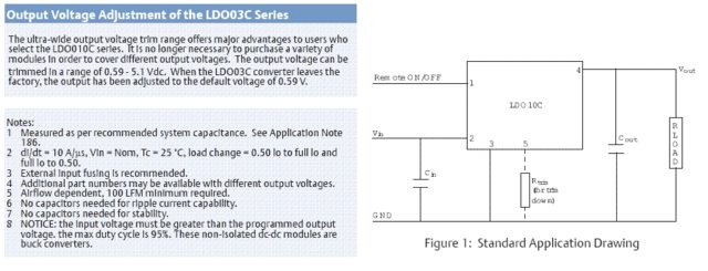

I want to make a guide on how to do this. I have an authentic SST-90 LED diode that I want to drive at full power. The only drivers I can find are ones for flashlights, which won't work for my landscape lighting because of the multi-mode "features". I simply cannot find a simple direct driver to buy, so I must make one.
Input source voltage- 6vdc
Diode forward voltage- 2.8-3.2v
current- 10a max
So I found this neat little driver-
LDO10C-005W05-SJ
http://www.digikey.com/scripts/DkSearch/dksus.dll?Detail&itemSeq=156141267&uq=635446457054251336
Datasheet- http://www.artesyn.com/power/assets/ldo10c_1191530952.pdf
and it seems perfect for my application. However, I need help on what capacitors and adjusting resistors to use. The datasheet is too vague and I am not a good enough engineer to know these things.
Here is a pic from the datasheet-
If you guys help me get a working module going, I want to create a full how-to guide for various voltages (6v, 12v, 24v) and post it here. I think it will draw a lot of attention for the simple fact that there isn't a guide like this on the web, that I can find anyway....

Datasheet here says 9 amps, but the sticking point seems to be the idea that you need to limit the current, not the voltage. A simple resistor of 3V/9A = .33 ohms, 26.73 watts (buy a 50 watt resistor) will control a 6 volt source from smoking that SST-90 LED. That's an awfully large resistor, but any linear regulator is going to waste that much power.
What you have in your LDO-10C is a switching regulator with 91% efficiency. Excellent choice, but it's a voltage regulator. You still need to add a current limiter. Perhaps adjust the LDO-10C to 4.08 volts and add a resistor of 1.08V/9A = .12 ohms rated for 20 watts.
Let's massage the numbers a little bit. My rule of thumb is to waste 15% of the voltage in the current limiter. That means to adjust the voltage regulator to 3.45 volts and use a resistor to waste .45 volts at 9 amps. That's .05 ohms at 4 watts (buy a 10 watt resistor). Here's a nice one for $1.62
http://www.mouser.com/Passive-Compo...Z1z0wo4tZ1z0wn1gZ1z0wlcvZ1z0wn9m&Ns=Pricing|0
I can not find the math for Rtrim on the datasheet so I can't say how to adjust the voltage correctly!
