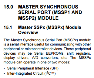

I am using a PIC18F45K22 microcontroller for a project at the moment.
I am planning to use both I2c and SPI as per this schematic.
The data sheet states there are 2 mssp modules, which i believe to mean i can configure them independently and have each one using its respective bus system.
I just wanted to confirm that i havent missed anything here as my lecturer was more than surprised that i was using both SPI and I2C at the same time.

You have it right: there are two independent modules and each can be configured as you wish.
I don't know why your prof is so surprised, I've done this several times when using say a RTC (clock) running off I2C and an SD card using SPI.
