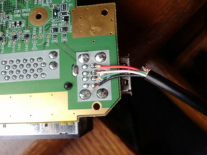

Hi, my mouse yesterday stopped working, suddenly. When I plug it in my PC, the PC detects it, but then it does not, and then it comes back, and so on. I've tried everything I know: different ports, computers... and the same thing in all of them.
1. Is this a hardware problem? I'm pretty sure, but who knows.
2. How can I fix it? I've recently purchased a soldering iron, a multi-meter and I want to start fixing electronic devices.
3. How can I check if an USB is working? I know it has pins, but it's almost impossible to touch one pin of one side and another pin of the other and see if there's low resistance (ohm).
I also have a USB cable that stopped working, and I wanna know what's the problem. I think it must be a defective pin, but I don't know how to test it.
Thanks!

If the led doesn't light up when you plugged into the usb then you should disassembly the mouse to measure the wires from usb plug to the mouse connector, if the wire is ok then take some clear pictures and then compress to 800x600 before you upload them.

Sorry. The mouse's leds light up (it has 2), all the time it's connected, it doesn't matter if the mouse is recognized or not, the leds are constantly lighted up.
Does that implies that the ground and 5V cables are working correctly, and could only be a problem related with the other 2 data cables (in case the problem is related with the USB cable)?
I've disassembled the mouse, but I don't how where to start.
That's one problem I have. I don't know how to test the pins. I don't know how to accurately touch only one pin, cause the USB is too small. The first thing I wanted to do is test if the cables are fine from the soldered circuit board end to the USB output pins. I can touch with one lead the end of cable soldered in the circuit, but the other end of that cable, which is one of the four pin, is not accessible.
Should I cut a female USB cable, separate the 4 cables, and then I would had a good way to measure that nothing is wrong from the USB interface to the circuit?

I'm assuming that you tried another mouse, and that one worked fine. That being so, try resoldering any connection that looks loose. The actual IC is probably sealed under a blob of epoxy, and if that's the case, there's nothing further you can do.
To check continuity of the USB cable, you may need to use a paperclip or some other sharp object to reach inside the USB connector. Check each of the 4 contacts in the USB connector against the wires inside the mouse.

I've re-read this thread and it's not clear to me that the problem is clearly hardware and clearly the mouse. You said in #1 you tried other computers. Did the mouse exhibit the same intermittent connection problem when attached to another computer? Did you use the same software driver in the test computer?
It's possible there is a firmware upgrade for your mouse. Check the manufacturer's website. Even reinstalling the same version of firmware could be worth a try.
Your mouse LED lights being on continuously seems to rule out a poor connection of the power leads, although not 100%. A very brief dropout - too fast to see - could be enough to force a reconnect cycle. But anyway it's more likely to be something else.
About the only thing you can do is rewire the cable. Anything else on the board of the mouse will be too small and too complicated to work on. Cleaning the mouse is a good step but it shouldn't be too grimy if it's only a few months old.
