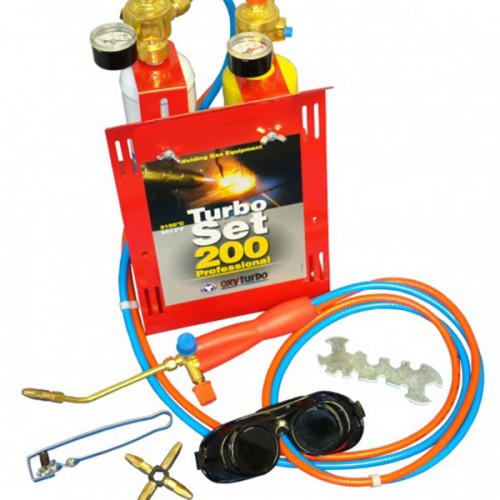

That is exactly the torch I used for up to 1/4" ss thin-wall tubing (hypodermic needle). Acetylene comes in an "MC" tank. I was told that originally it was used for motorcycle lights. At least it is easy to remember. You will want a larger oxygen cylinder, probably. I made my cart out of 1/2" threaded steel pipe and use steel worm gear bands to hold them in place..

You will need to find a welding supply shop. The torch and gauges are the easy part. The tanks not so easy for the home DIY guy. Probably cheaper in the long run to job it out to a welding/machine shop.

Good Ole Wally World https://www.walmart.com/ip/Gas-Weld...ote-Brazing-Cylinder-cu-Not-Included/23480239
Full kit without gas. Must be filled at welding supply shop or rather exchanged for full tanks or sent out for filling.
But you need to visit your welding supply shop first. Here in the states, the tanks are inspection date stamped and gas suppliers are finicky about taking "Odd" tanks in trade for full cylinders.

Same thing down here, more or less. I'm looking now for disposable mini-tanks.

That varies based on location in the US. In one town, I had the choice of demurrage (basically a daily rental) or buying the tank. Buying was much cheaper for me. I now "own" my tanks, which doesn't mean I always get the same tank back. In my current town, you can also just leave a deposit that doesn't increase with time. Cost of refills may vary with whether the tank is rented or owned. Also, all tanks need to be pressure tested at some interval. Since I don't usually get the same tank back, I have never had to pay for that pressure testing. When I exchanged my MC tank for a larger acetylene tank needed for heating and cutting, I got the current full cost credited to the new tank.
In my experience, welding shops are interested in selling the gas, and over time, that's what you pay for assuming you want to keep an outfit ready. The tank charges are only to deter theft.
I have 4 tanks: acetylene, oxygen, argon (for wine and TiG), and argon/CO2 for MIG, As for gauges, while a single stage will work, I recommend two-stage regulators for oxy-acetylene stuff. You will get a much more stable flame.
I think you will regret that. Once you get into it, you will find other uses.
Edit: A 2-stage regulator is probably less important for acetylene than for oxygen. Acetylene is not pure acetylene. It is dissolved in acetone for stability and the pressure change with use is less.

How do you mean? That I'll somehow use the tanks separately for a different purpose?
No, he means that once you start gas welding or brazing or soldering, you will find other things that you can weld, braze or solder. The recurring cost of disposable tanks will start to add up quickly.

Those jewelers torches work with a regular set of full size tanks and regulators. They attach to the end of the existing hose, where the normal torch would fit. Got a set of them but they aren't as nice to use on anything very big, the HAZ(heat affected zone) grows because it takes so long for the small flame to heat up.
That Torch set from the UK is also available here in the states by Bernzmatic. It uses a throw away oxygen tank and MAPP2 gas. For what your doing(small) a MAPP gas torch should work I have this one and have used it on some HVAC work using the Stay Brite#8, 3/4" copper tube. https://www.bernzomatic.com/Products/Hand-Torches/Instant-On-Off/TS8000
