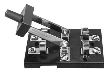

The mains protection is for any generation on customer premises; here is one vendor for the relays and some explanation
----> https://www.ipu.co.uk/products/comap-g59-mains-protection-relays/
A neighbor has such with his 'Generac' emergency/backup/standby/auxiliar generator. Shuts off the power utility connection from reaching the dwelling when the aux. generator supplies power to the house during an outage. After a selectable time of energy restored, shuts off the generator and restores connection to the utility.
I believe that relay set is called 'transfer switch', I wired it and is working fine. :eek:
It is the red part on the image, driven by the two black solenoids at its left, looks like :
Sort of an automated
