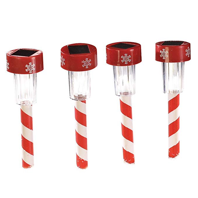

For what it's worth, my lights look a bit like these:
