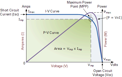

You can reasonably expect to get 4W from each cell if the load is perfectly matched to the line of cells ... You can see from the graph if the cells are short circuited the current is max but the power you get out is zero , open circuit power out is zero .... To get the max power out the voltage across the cell should be about 0.48V , you have five so that's 2.4V ... So when your 5 cells not connected to load the voltage will be about 2.75.... when you connect the load if voltage drops to 2.4 then you know the load is matched perfectly and you are getting the most you can from the cells .... It will never be perfect , if voltage with load is 2V then you get perhaps 85% full power .... that's just in full sunlight to keep getting max posible power in all light conditions requires complex circuitry ,it's call MPPT Maximum power point tracking.
