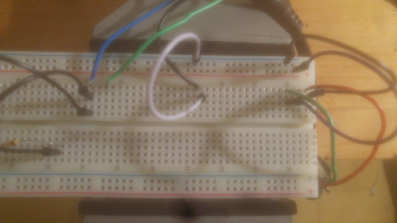

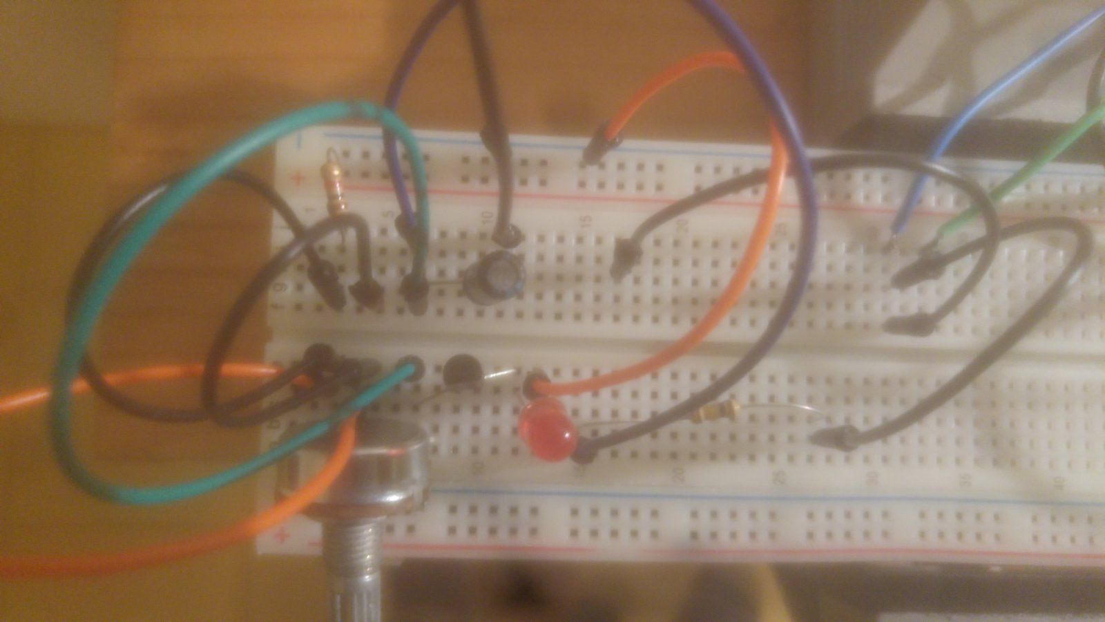

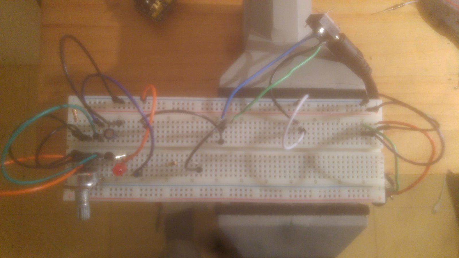

Hi i build the tansistor oscillator of look mum no computer and it dosent work i canot find what is the problem ,its my first electronics project
Hare is a link to the projecthttps://www.lookmumnocomputer.com/projects/#/simplest-oscillator/
And some photos of the breadboard
It working on 15v 1.5a charger
I connect it to a amp in stereo aduio jack
The led is working and knob is controling its brightnes
Tnx for all the ansers im really stak

The pictures aren't clear enough to be able to trace the circuit.
Make sure you are using a 2N3904 transistor withe middle leg disconnected and the other two connected the right way round.
Do you have a multimeter?

If you connect and disconnect one of wires connected to the 100k resistor do you hear clicks from the amplifier?
If you hear nothing when you do that then there is a problem with the connections to the amplifier.
