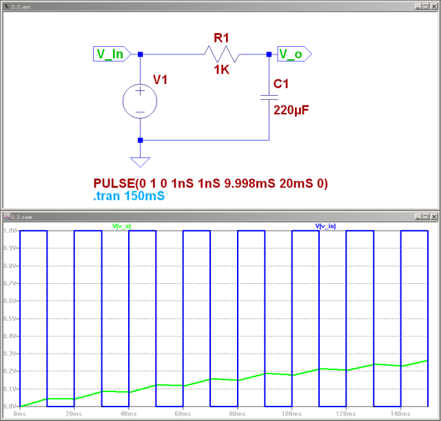

Ok, next question I have is about time constant in an RC circuit. I know that time constant for an RC circuit is tau = R.C
Our teacher is asking us to simulate the attached circuit and simulate it for different frequencies. But shouldn't the time constant be always the same as time constant doesn't depends on frequency, by the above given formula? Or how does time constant varies with frequency and why?
I've simulated for different periods (frequency) and the time constant looks like is not what it should be.

Of course the time constant is constant as long as R and C are not changing. So can you tell me what led you to this conclusion ?
For me the simulation result are correct. For R = 1kΩ and C = 220μF tau is RC = 220ms all the time.
In your simulation you set Ton ≈ 11ms and Toff ≈ 9ms.
So after t = 11ms the capacitor voltage will reach Uc = 1V*( 1 - e^ (-11ms/220ms)) = 48.77mV. Now the capacitor start the discharging phase and again with the time constant equal to 220ms. So after t = 20ms the capacitor voltage will drop to Vc = 48.77mV e^-9ms/220ms = 46.815mV.
Next again the capacitor will start the charging phase and after t = 31ms the capacitor voltage will reach
(1V - 0.046815V)(1 - e^ (-11ms/220ms)) + 0.046815V = 93.3mV, notice that the capacitor will be charging with time constant tau = 220ms to the difference between Vcc and the value to which the capacitor previously was charged. And at t = 40ms Vc = 93.3mV e^(-9ms/220ms) = 89.56mV.
And at t = 51ms Vc = (1V - 89.56mV)*(1 - e^ (-11ms/220ms)) + 89.56mV = 133.96mV and so on.

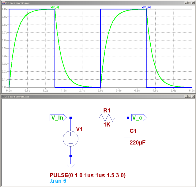

Now I understand: you did not actually understand what your teacher is asking you or you do not know how to set the test in LTSpice. His request makes sense.
Open it, see what is different from yours...and then do the changes (variations) he asked for...and take the conclusions...and then comment them here.
Thanks for you reply...
I setup wrong my Ton and Toff. They should be 9.998mS for both (plus 2nS from Trise and Tfall would sum to the total of the period of 20mS).
What is leading me into confusion is the fact that when I change the frequency, I can't see the 1st time constant at 220mS (~63% of the full capacitor charge)!
I have to ask a few question to avoid any misunderstandings. You use Uc for charging phase and Vc for the discharging phase. Was it on purpose??? Is there any difference?
What is exactly the formula you're using to calculate capacitor's voltage at a given time?
Is it:
where V is the previous capacitor voltage???
If so, why do you consider capacitor voltage at 11mS as 1V??? Shouldn't the capacitor theoretically reach 1V at t = + infinite???
Tell us about this input signal your calling "frequency"? What type of signal is it? Sine wave? Square wave, if so, what is the duty cycle? Triangle wave? Pulsating DC, again, the duty cycle?
What are your testing standards with respect to tau? Is f = 1/tau or some other discriminating factor? Can you tell me your testing plan or are you going to randomly pick a frequency?
For me, I don't use LTSpice, so without a schematic, I can only imagine your circuit.
I have posted my schematic in post #11.
We are supposed to simulate that circuit with a square wave signal for Vin with 1V peak-to-peak ignoring negative values, which means from 0V to 1V and not from -0.5V to 0.5V. Then we should make a few additional simulations for different frequencies to see what happens.
The duty cycle is supposed to be ~50%, that's why I did 20mS for period, 9.998mS for Ton and for Toff, 1nS for Trise and Tfall. If I sum these values, I guess I'll have the 20mS period...
The frequency I'm talking about is just to see what happens in the simulation. So I change the frequency by changing the period!
I certainly see your simulation's point of view... You used a very small frequency (0.33Hz->3S period) so that we can see the capacitor discharge phase. And also used a pretty high Von value of 8V.
The difference is not that much, I guess. It's only a matter choosing enough reasonable values to see the capacitor's charge and discharge phase. However our teacher said to us to use a Von peak value of 1V without negative values (from 0V to 1V).
So, this said, and knowing that a period based in seconds and not milliseconds, what would be the frequencies to use in a few additional simulations as teacher asks?

Normally an assignment like this would have one of two things as the intent. The first would be to demonstrate that changing the frequency of the input signal has no effect on rise and fall time. It makes sense to use a square wave for that. The second is to demonstrate the effect that a circuit with a fixed time constant has on a signal of differing frequencies and a sine wave is normally used for that, although a square wave can be used.
PsySc0rpi0n
Joined Mar 4, 2014
1,786
You posted a file in Post #11 that requires the reader to download the file and open it in LTSpice, which JoeJester said that he doesn't use. It's fine to post a schematic in such a format so that people that happen to have that particular CAD tool can download the file and play with it if they choose. But you should also post an image of the schematic, preferably as a PNG file, in your post as well so that everyone can see your circuit.
Didn't understood that... I'll post it right a way!
This was what I had before
