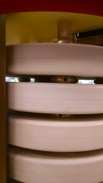

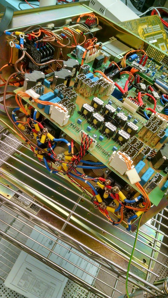

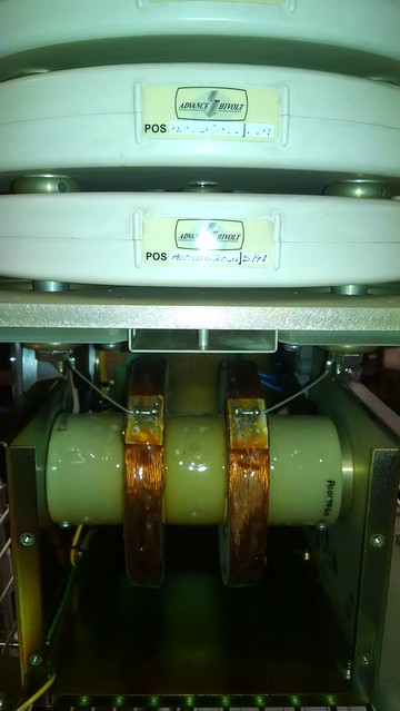

Expensive but reliable. This 10kW 100kV driver unit is undergoing inspection after almost 20 years of 24/7 duty. The main reason is to source obsolete IGBT and snubber diode modules for future repairs. The unit was pulled after the fan stopped running after 20 years.
