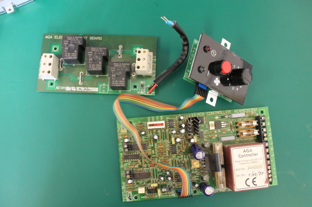

Hi there,
Can I just ask if it was easy to replace a relay switch? I have one that is "buzzing/vibrating" and needs replacing. I've purchased the new relay and was just wondering if I need any special solder due to the AGA's running temperature?
Many thanks

The information is too vague to give any helpfull advice,
DC relays very rarely buzz usually the AC variety is prone to this.

There are a few possibilities, the 24vdc coil voltage is low (but I doubt it), the contacts are burnt, the device/circuit driving the relay coil is defective in some way.
I would check the DC voltage on the board if possible and also the voltage across the coil when energized, for the price it may just pay to replace the relay, as these are a common cause of no element heat etc.

Would I be able to use standard solder when replacing the relay, given it is on a PCB and an AGA has high running temp?

Yes. If the running temperature was high enough to melt solder, it would have turned the circuit board brown a long time ago.

We'd need the original relay's specs, or at least a picture, to help you out. Also, most relays are mounted on a special base/socket that makes it easy to remove without the need of soldering.
Max is right, the AC kind of relay is prone to buzzing, but if it's a DC type, it could mean that the relay's coil is not getting enough current... could mean a damaged transistor or intermittent contact on the PCB... but let's start with the specs first...

Sorry all, my fault - tagging onto the end of an old thread - will let you know how it goes with the relay being replaced
