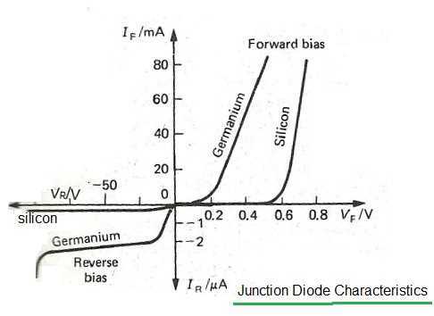

Is that .7V for ANY transistor?
Thank you, BTW
For silicon bipolar junction transistors (BJT), this is a commonly used approximation. Small signal transistors generally operate at higher base-emitter voltages than power transistors owing to the much larger area usually used in power transistors for heat management. The voltage drop typically increases by about 60mV for every order of magnitude (10x) increase in base-emitter current (and, in the active region, the corresponding collector current). So if a given transistor had a collector current of 100 mA at Vbe=0.7V, it would have less than 100 uA at 0.5V and nearly 10 A at 0.9V. As a result, for most purposes, it is reasonable to treat the base-emitter drop as a constant as long as the transistor is in the active region and values of 0.6V, 0.65V, or 0.7V are the most commonly used values and it almost never matters which value you use (generally, but not always, if it does matter, then the circuit was poorly designed).
