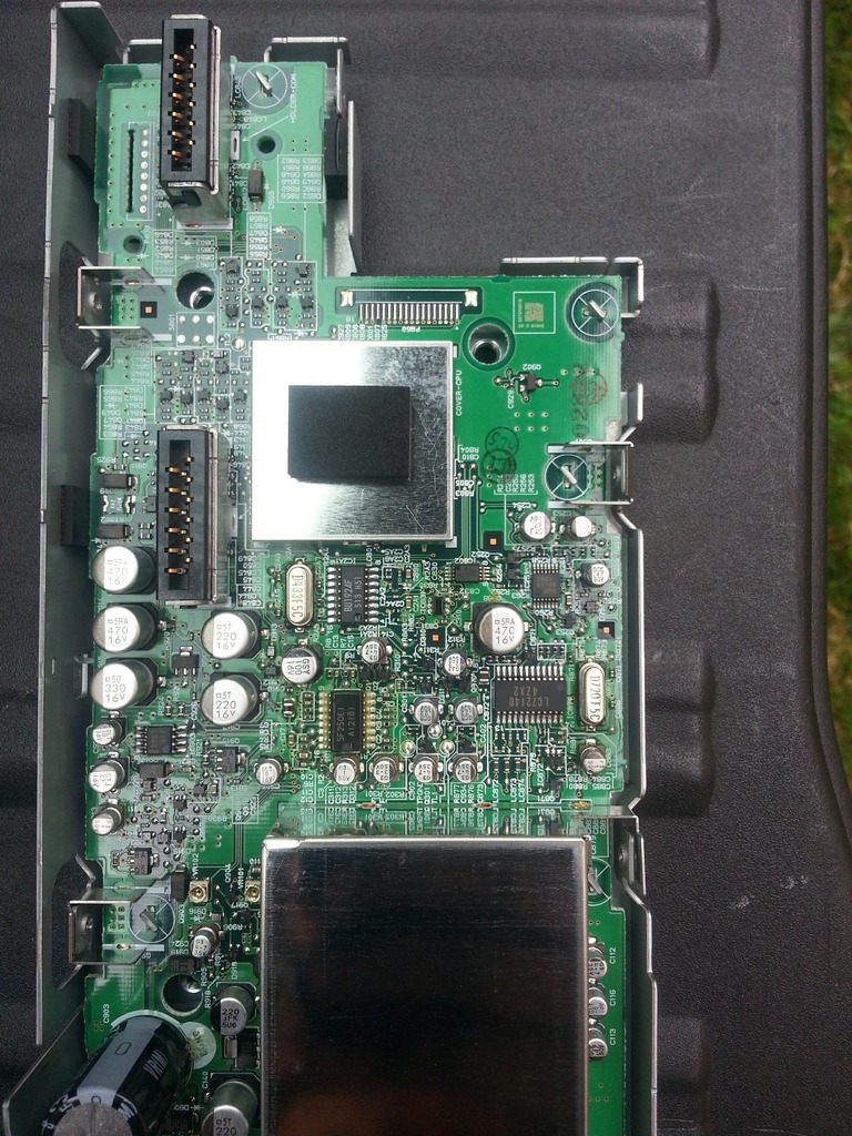

Good morning,
I joined this thread from hearing about another thread for my car.
Iam from London and working as a Chef.
I would love to do my own repair mechanically and more recently want to do my electronic repair as well like replacing LCD screen changing micro USB port for my broke USB port.... Stufflike this with small works.
Yesterday I was soldering a 3.5mm wire to the radio unit in Volvo xc90 to create an aux input , so I can play mp3 from my mobile.
After doing all the work as said in the above forum- solder left wire to one capacitor and right wire to another capacitor and ground to one point in PCB-but the speakers working in right side only.
But when playing CD player all speakers working. But with the aux plug in no sound from left speaker.
What could possible mistake I've done please.
Can some one shed some light on this .
P.s first time when I switched the unit after done the work I stupidly didn't give proper earth . the radio unit serves as a whole like earth but I made a mistake. Will this done a blow in circuit board.
Or the 3.5 mm plug .
Please some One help.
Thank you
Saravan.
Below is some pics of the work. Thus circuit board is same like the one attached PDF guide where I got the information.
Thanks again .

I can't see any picture of where you have soldered the three connections to the board so I cannot tell what is wrong but here are some guesses.
1. The wires you are soldering are stranded and maybe one of them has a strand sticking out and shorting to some other connection nearby.
2. The insulation on the wires is easily melted by the heat of soldering and this heat can travel up into the cable and damage the insulation inside the cable causing a short within the cable.
3. You cut the wrong track by R9 or accidentally cut another nearby track as well.
4. The track by R9 is not completely cut.
5. There is some problem with the cables not caused by you.
For 1 to 4 very careful inspection should reveal the problem.
If you have a multimeter, with the unit switched off and not connected to your phone, check resistances as follows:
From the outer connection of the plug to the radio chassis - this should read very close to zero ohms.
Between the inner and outer of each plug - these should not read zero ohms and the two plugs should read approximately the same.
With the radio switched on and not connected to your phone, hold the metal part of screwdriver and touch the centre pin of each plug with the tip of the screwdriver. You should hear some clicking/scratching/buzzing sound from one of the channels.

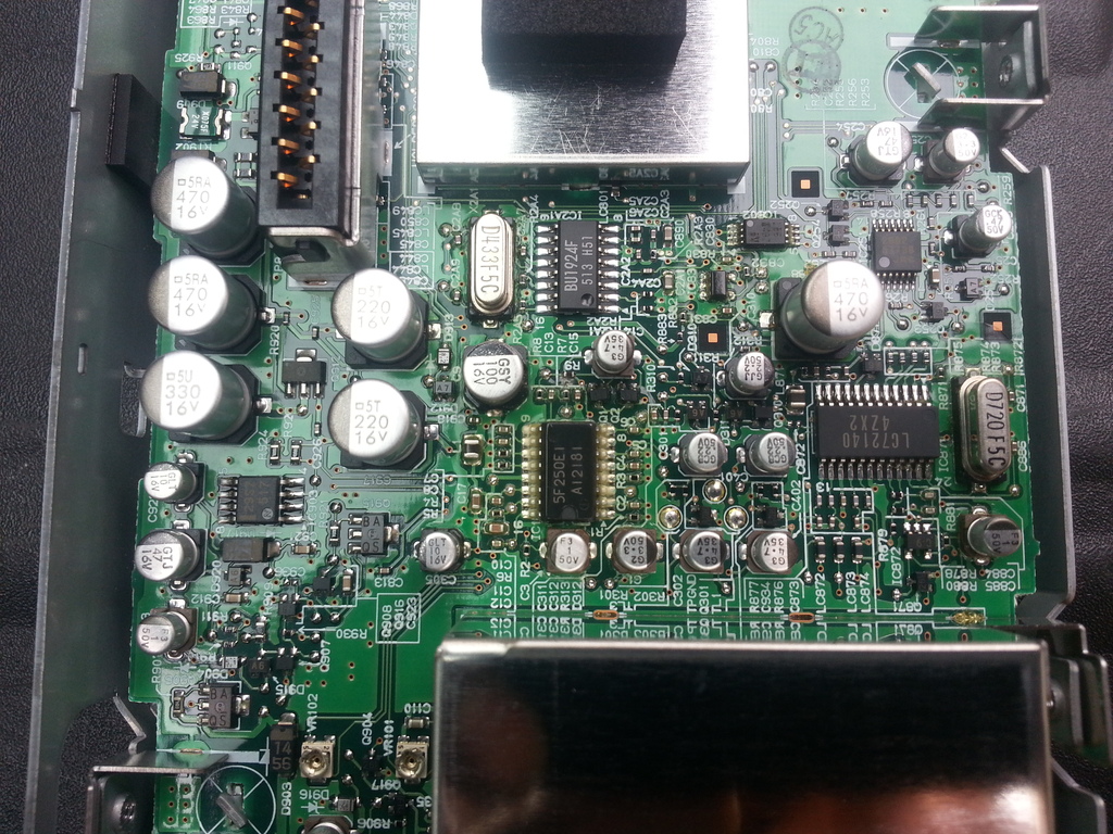

Good morning,
Thanks for the advice. If you look a the following image I solder the left and right speaker wire from 3.5 mm cable the capacitors C301 and C872 on the positive side. Those are the two capacitors above the five bottom lined capcitors.
Ground is near those capacitors you can see a big blop of solder. That's where I attached it.
original guide from another user I attached in the PDF format. Please have a look .
Mean while I will use your advice to sort the issue.
Thank you
Saravan.

Right . I've just touched the three points from the 3.5 mm plug and found that there is no sound from the left but some buzzing sound from the right.
Do you think I blown my capacitor?
Thank you
Saravan.

Thank you for all your guidance. As all of yiy said I did a big mistake by using a thicker solder tip to do the work and Burnt the wire itself and ruined it.
I removed it and tried resolder it in a near by shop who does the laptop for 5 pounds.
And voila job done.
Thanks for a detailed explanation and guidance. My aux plug is working like a charm. Mean while I live in London UK.
