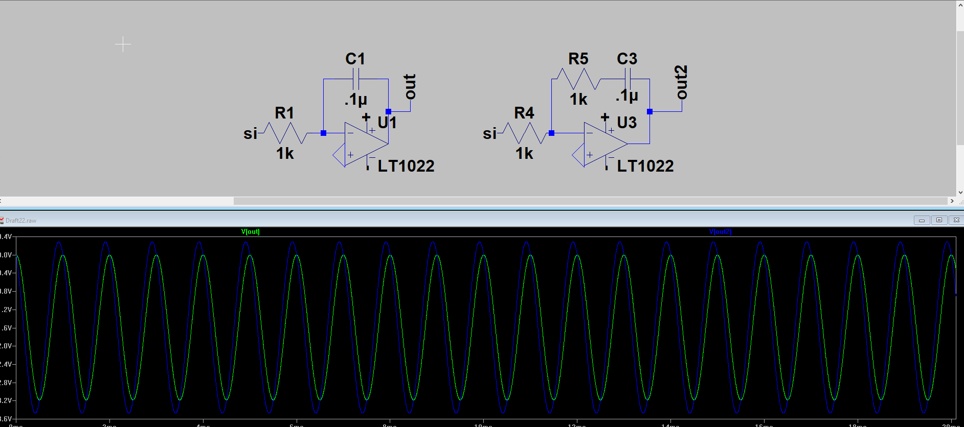

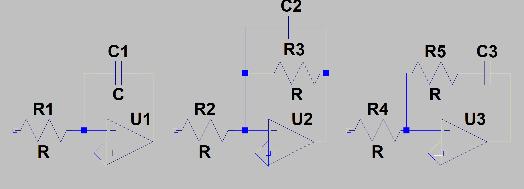

I have a question about the gain of opamps in different configurations.
I've seen these 3 times of opamp compensation around but I do not know what the difference is.
How does each configuration affect the gain of the opamp at different frequencies?
I would prefer an answer with as little math as possible
Thanks.
