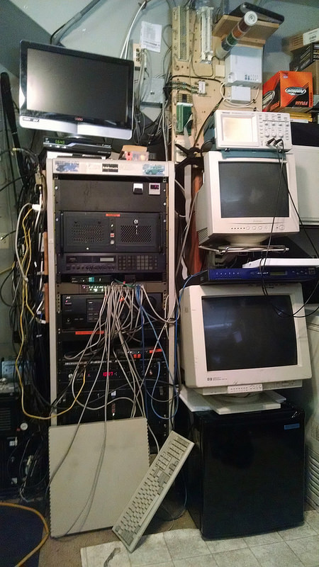

Wise precaution. Unless you are very sure about the level of grounding and circuit protection a disconnect is the best thing. Thunderstorms are rare here too but my house is still grounded and protected like I like in the tropics with a bonded loop ground with several rods for the house and antenna connections. I've no external cable or phone connections (dug-up and removed the wire on my property) and the internet is a 100Mb symmetrical fiber-link to my own Linux firewall and router on a well grounded rack-mount.
