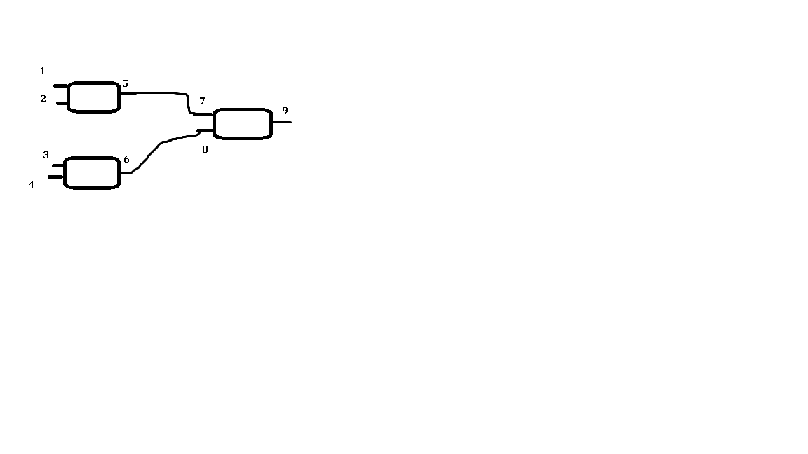

assuming these are all and gates, if pin 1 and 2 were reading high and pin 5 was not connected, what would pin 7 be reading for an input??

well its for a troubleshooting assignment, so i just wanted to clear it up.. but telling by that picture, would pin 7 be reading high or low? if pin 5 was not connected and pin 1 and 2 were high

If pin 5 is not connected then it doesn't matter what is on pins 1 and 2.
As you said in your opening post, unconnected TTL inputs tend to float to 2V which would be considered a logic high.

You need to recognize that if Pin 5 is unconnected, then that means it is unconnected from Pin 7 and therefore has absolutely no bearing on what Pin 7 is or is not. For TTL, Pin 7 is simply an unconnected input that should be pulled high internally (though, as already stated, this is a poor idea to do intentionally).
WBahn
Joined Mar 31, 2012
33,161
Pin 7 would be floating. Therefore the state of Pin 7 is not predictable.
Remember that he specified TTL. While it is poor design to leave a TTL input floating, the behavior IS predictable (provided there isn't too much noise, which there usually isn't). This is NOT the case for most CMOS families.
