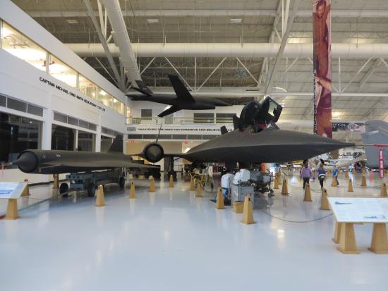

They had several countermeasure packages for missiles
We have one in Oregon.
and the CIA had their A-12 to play with.
The only one I ever got to work on -- and I am grateful both that I got to work on one and that I only had to work on just one -- is (as of about 2004 when I was there) on display at the Pima Air Museum near Tucson, AZ. It was parked almost right next to one of the F-15's that I had also worked on. Other than those two, the only other bird that I know of that I physically worked on is the F-15 on the Terrazzo at the Air Force Academy.
