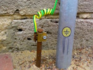

Your second ground image doesn't tell me much? What is the rod alloy, how deep is it driven into the ground and what is the ground (dirt) conductivity as in soil PH? There are specifications for all of that also.

Does the antistatic wired bracelet only work if you place the claw on that ground bar?
I handle the electronics on a table or bed very far from this bar

I am from Brazil and here the socket has 3 pins with grounding but the workplace is distant if I connect this claw to any metal will it work to unload the statics and protect the electronics I'm handling?
No, the metal must be grounded. Looking at that ground rod, when the ground wire was clamped to the rod, it seems the wire is not clamped under the clamping bolt. Looks like they missed the wire and just wrapped the wire around the rod. The wire should be crimped between the clamp and the rod on the side away from the tightening bolt. In order to ensure integrity, it has to be "Megged" to determine if the ground is actually going to earth!
