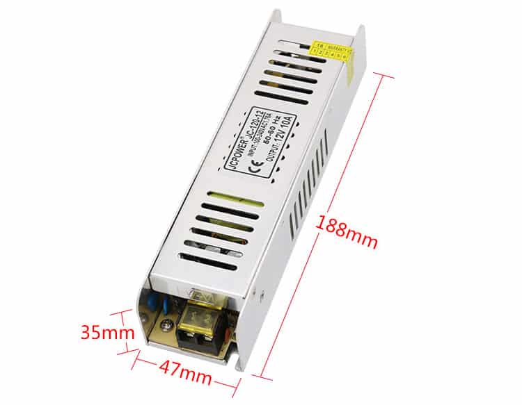

This does look quite promising... and is even slimmer than the brick too as you mentioned.
The input is listed as 100-220VAC, would that be an issue?
Otherwise as far as I can see the only remaining benefit of the brick is due to the casing which might make it a bit safer in some respects - but from what you have said the open case option would perform better.

100 - 220v just means its a universal supply for both US & EU markets - the brick is similarly spec'd.
The 5.5/2.1mm connector on that brick is rated a 5A. It will of course work at 10A but it will be getting warm and those types of connectors are designed for hot plugging/unplugging - at rated current. They will fail prematurely at higher currents leading to poor contact, increased heating/arcing and could even weld themselves together. You'll have to cut it off anyway so its moot, but the cable size is relevant.

Ok, with on those lengths you can get away with 20awg (0.5mm^2 stranded), PVC sheathed wire between psu, controller, and fan array. At full output the copper temperature will be 70-80degC, though some would prefer 18awg/0.75mm^2. Or for added comfort, the silicone sheathed wire is more robust & flexible.. My usual source is wire..., has 18 in stock but out of 20awg, or here

Ok perfect, I think I will go for the 18awg PVC cable, along with the variable controller and smaller (120W LED) open case PSU.
Would you recommend I buy a 3 pin plug along with a ~1m L/N/E wire, where I could perhaps attach the earth to the PSU casing? Again, other than perhaps repurposing one I might find lying around I'm afraid I'm not sure where I might find one suitable.

Yes, easiest solution is to buy an IEC cable (UK plug top to IEC C13) and cut the C13 connector off.

After lots of waiting and issues with the orders I placed (the PSU never arrived and something else was sent instead of the PWM controller), I finally have received enough parts to assemble the circuit (although still waiting on the controller so was only at max speed).
I'm very happy with the performance of the fans and the PSU so far, everything seems to work perfectly. I haven't run them for very long yet to see whether anything heats up more than it should, but nothing at all notable so far. Thank you for all your advice!
One thing I would like to do is somewhat splash-proof the PSU if possible, but with the current arrangement I have very little room for a casing. Would wrapping it in a thin plastic sheet/casing be suitable? I wasn't sure if this might cause it to overheat etc.

The PSU is in a perforated ally case IIRC. It's power rating assumes normal convection cooling so covering it up is a bad idea. Yes, it will overheat but whether it shuts down or dies I can't say, I would hope/expect the former. High voltages and liquid = short circuits (bad) and even after drying = rapid corrosion if not properly cleaned (very bad).
You could put it in a box, and add a centrifugal fan blowing air through it (air flow parallel with the heat sink fins). Needs to be fairly powerful airflow because the holes aren't that big.

So far I have attached the PSU and controller together to a base where the speed can be easily adjusted. I think I can live with the PSU being simply in it's case as at least it (pretty much) encloses all the live connections, but intend to add some form of cover to the terminals on the controller at the very least to help stop a careless user touching them.
