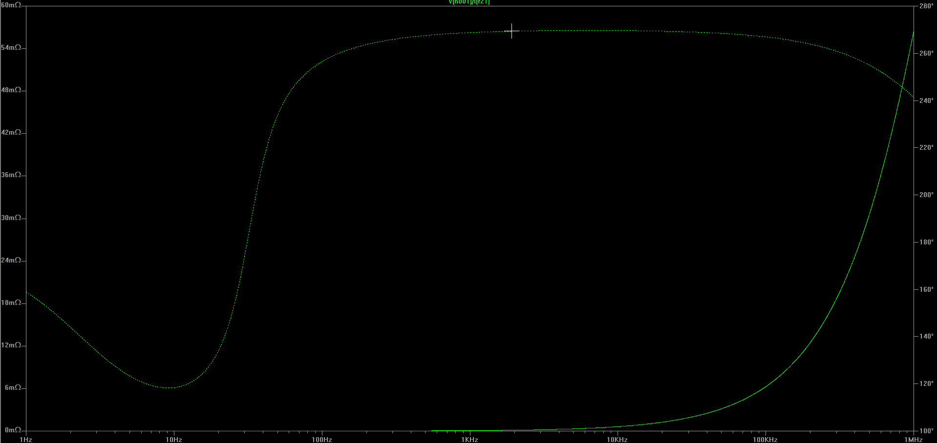

My understanding of feedback theory and instability is limited because my experience with them is limited.
I was designing a power supply in spice to improve on my current one and I think it's time I fully understand what spice is telling me here.
This is the spice reading of the old supply
This is the spice reading of the new one

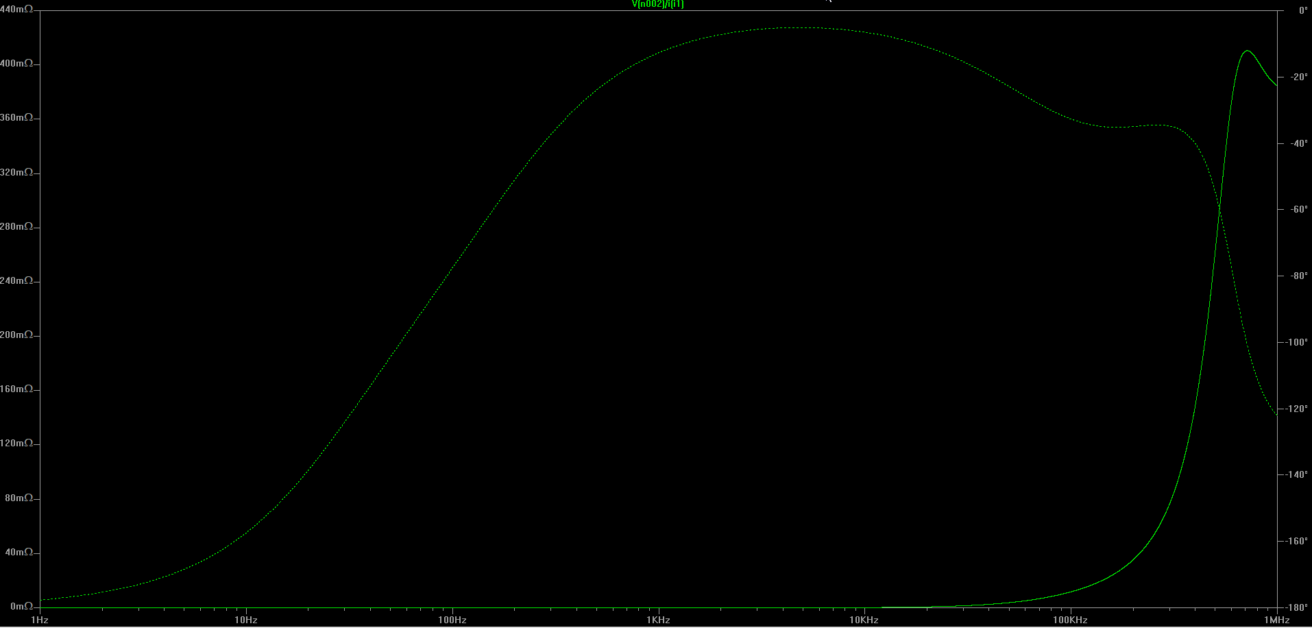

The output impedance is improved but I don't understand what the phase reading is telling me. What does it mean exactly? Phase of what? Why/where does it matter?

Why are you concerned about the output impedance versus frequency in your power supply?
Do you have a requirement for a fast responding supply?
The phase is normally shown between the input (source) and output voltages.
In this case, I'm not sure what it represents.

It's for an audio supply. I want the impedance to be as low as possible between 20hz 20khz to eliminate it as a source of possible distortion. Of course the performance of the previous power supply was likely more than sufficient for practical purposes but it was a 200v supply using a 20v opamp on the high side. Too many time's have I had to repair this circuit so I built a low side version instead. which just happened to show better performance impedance-wise.
I just don't understand the meaning of the phase reading.
I hooked them both up to a current source 300ma idle 100ma current swings and measured the the output of the regulator using Vout/ILoad to get that result. What does the phase mean here?

For stability you want the phase shift to be much less than 180° (good phase margin)
So by this logic the result of the second picture I posted is much more stable than the first?

Oh okay so as long as gain doesn't cross 0db and 180 degree phase shift at any frequency it is stable right?
As an example this measurement is stable to 1Mhz?
No.
Your supply is showing a gain of -180dB (Av = 1E-9), which is essentially no gain (the same as if the supply was not powered).
That's likely because the supply is biased off with no load.
In order to do the test, the power supply must be supplying power to a load with all active elements conducting current.
An AC voltage source is added at the amplifier input with an AC voltage of one.
Normally the gain will be much greater than 1 (0dB) giving a positive dB number.
A negative dB number is a gain less than 1.
If you are simulating in LTspice and upload the .asc file here, I can try to run it and check the stability.

The output of the supply is connected to a 300ma current source. It's definitely not unloaded.
Although I put the AC1 on the current source not on the input.
Putting AC1 on the input doesn't really change it much though.
