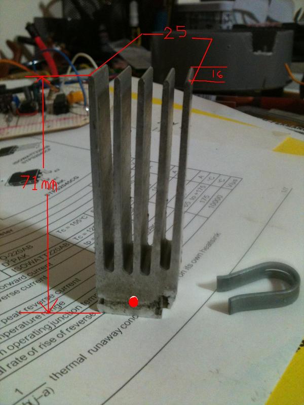

liteace
Joined Mar 7, 2012
242
I have this:
It was massive, ive cut it down, Im going to drill a hole through it where the red dot is at the bottom, I also have a clip, I hope that will do the trick.
I also have been having a play, I mounted the Schottky diode and the LED, that works well, when the polarity is reversed there is no power at all on the board so would this work, ive taken away switch 1 and am going to (if it will work) put a 40 amp relay in there, the badly drawn wires are for the coil side of the relay
BillO
Joined Nov 24, 2008
1,001
Well, if you are using that circuit, you don't need an enormous diode. One side of the one you bought ought to do it. I am assuming the 40 amp relay will switch the power feed to terminal 1, right?
Heat sink looks fine, just make sure the metal plate on the back of the MOSFET makes full and complete contact with it. A little thermal compound might be in order.
