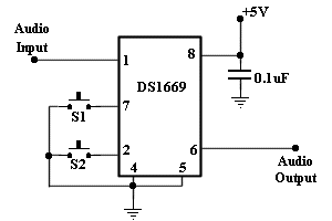

    You can use a dual digitally controlled pot, but you will need a microcontroller between the touch pad and the DCP to make it come out right. The USB part needs some intervening controller to handle the signals.
    I use a pair of pushbuttons for UP/DOWN control, and it still takes 12 CMOS logic IC's to control my preamp functions. It's ugly, but it sounds good. And it lives in a closet.

    Oh, neat. Yeah I am doing it more for fun and experience...
    http://www.intersil.com/data/fn/fn6422.pdf
    THis good?
    Also,
    what kind of microcontroller would you recomend? I am still in school for EE :p and I am still getting there. I guess I would have to program it (I favor the Atmega8) maybe the ATMEGA8-16PC? I know simplistic but I don't need anything intense do I?

    You can try using this chip and a capacitance sense circuit to its microswitch to make what u asked.. Is this the one??

    Bear in mind that the max supply for this chip is 8v

    AHAHA! your awesome.... I saw that the other day but I could not find it afterward :'(
    This will be perfect.
    I don't even have to program here, I am very happy right now!
