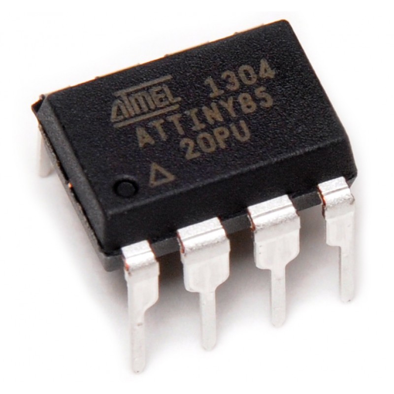

Changed the program to be a little more efficient using a subroutine to
do the relay turn on rather than a bunch of if-then statements.
By the way, I think it will fit into this to do job.
