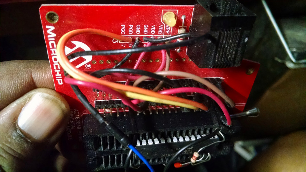

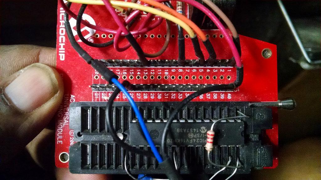

I apologize in advance if this question is beyond the scope of this forum based on its relative level of simplicity, but I am eager to get started on a /long/ quest to make a machine. However, as I expected, the connecting of the PicKit3 to the device is and probably will be my only main obstacle.
I keep getting an error on the MPLAB X IPE output when trying to connect:
Connecting to MPLAB PICkit 3...
Currently loaded firmware on PICkit 3
Firmware Suite Version.....01.50.04
Firmware type..............dsPIC33E/24E
Programmer to target power is enabled - VDD = 3.250000 volts.
Target Device ID (0x0) is an Invalid Device ID. Please check your connections to the Target Device.
I have recreated what I've done here:
https://imgur.com/a/sJjbL
where 104 is a non-polarized ceramic capacitor
Can anyone shed some light on where I am going wrong and how to possibly fix it? I just want to get started already. I've been at this for 2 days already and I'm getting restless.

Check VDD from PICkit if external is selected you still need that pin vdd connected.
now mclr Pic pin running from pic a 1K first then 100nF to gnd from 100nF 5-10K to Vdd.
Pickit3 mclr direct to Pic pin.
This allows the pickit to flipper mclr and eliminate the 100nF effect while loading.

In addition to a 10 kΩ pullup resistor between MCLR and Vdd, you also need a 10 μF tantalum or ceramic capacitor connected between Vcap (pin 20) and Vss (pin 19). It's unlikely the chip will work without it, as it's needed to stabilize the PIC's internal voltage regulator supplying the CPU core.
Section 2.1, Basic Connection Requirements, in the data sheet should be followed rigorously for this chip to work; it's not very forgiving of poor construction technique.

Thanks for the Vcap connection reminder. I have one on my PIC24 images but forgot to say it's necessary.
