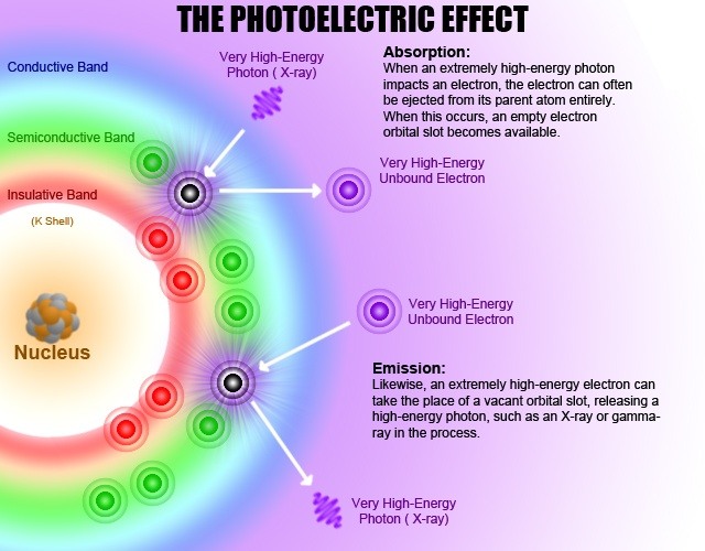

Ok I’m still not satisfied with the answers. I believe it’s purposefully evading the direct question due to the duality of electron and light theories. Electrons are actually ejected in the photoelectric effect. There is an electron flow out of the base and creating hole current in the system.

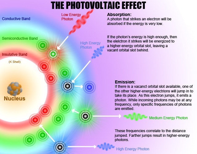

Yes, but here we are talking about the photovoltaic effect, here, we don't get unbound electrons ejected into space. While similar in theory there is a difference between the two in physical operation.
https://en.wikipedia.org/wiki/Photovoltaic_effect
The main distinction is that the term photoelectric effect is now usually used when the electron is ejected out of the material (usually into a vacuum) and photovoltaic effect used when the excited charge carrier is still contained within the material. In either case, an electric potential (or voltage) is produced by the separation of charges, and the light has to have a sufficient energy to overcome the potential barrier for excitation. The physical essence of the difference is usually that photoelectric emission separates the charges by ballistic conduction and photovoltaic emission separates them by diffusion, but some "hot carrier" photovoltaic device concepts blur this distinction.
