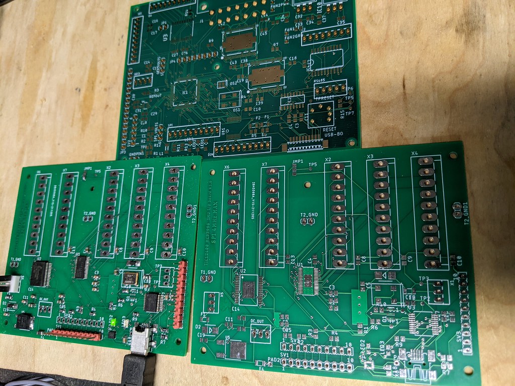

I'm not getting it. If they are objective, share the numbers with a board recently made by your favorite foil - JLCPCB. Not a board made before they set up their new shop - a recent board from the past three years.
The thread subject is:
PCB prototyping and manufacturing in the USA
but here are some recent examples of JLCPCB boards I've ordered. Perfectly good for a hobby level PCB at the default quality but not equal to OSHPark even with upgrades.
https://forum.allaboutcircuits.com/...-manufacturing-in-the-usa.185238/post-1713099
JLCPCB default quality
OSHPark default quality.

My objective standard is IPC class 2 as the minimum quality - and JLCPCB meets those specs. Better quality is available from JLCPCB. OSHPARK does not list a quality standard on their website. So, since no numbers are available (even when asked twice) - the phrase "objective standards" really seems to be subjective, personal opinion, wishful thinking and fandom standards

Some people have higher standards than others.
Yes, proud to be a fan and a supporter of a good business doing quality work.
I've selected and evaluated the JLCPCB product many times and will continue to use it on hobby-grade projects.

No I'm not misusing the term. My top "objective standard" is that the board work as designed and built. I've have board failures with JLCPCB boards on fine-pitch traces even with their upgrades. I could care less about some IPC class 2 standard listed on a website if the actual stuff they make is inferior and fails in the field.
JLCPCB trace repair after operational failure of a signal trace to a SPI port from a PIC32 TQFP-100 part.
It opened somewhere between the via and a inner trace. I've not had this problem with less critical line-widths on their boards.
These boards are all JLCPCB. I use them but I also know their production quality limitations.

i have to say my boards including ones from JLC are all sparkling clean. that board is clearly dirty and corroded. looks like it may have spent some time exposed to elements. are you sure that failure after such experience can be attributed to the PCB manufacturer? you did mention quality difference and of course there will one given the bargain price JLC offers. but comparing el cheapo PCB with tin finish that spent some moths at the bottom of the lake with a shiny and new gold finish PCB is not exactly fair.

I can't figure out how the spots, dust and grime were so evenly dispersed yet randomly sized to get this effect (or why).
photo zoomed in from post 35.
