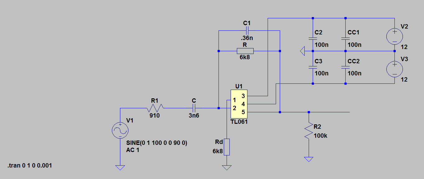

Hello. I've designed differentiator scheme in LTSpice and for some reason it's not working properly. Values are okay I think, I would love to know what am I doing wrong, since I'm trying to get this to work for few hours now. Phase is completly wrong on the output and I'm not sure if capacitor C1 is needed. My scheme:
This yellow box is op amp, 1 - non-inverting input, 2 - inverting input, 3 and 4 +/- power supply and 5 - output.
